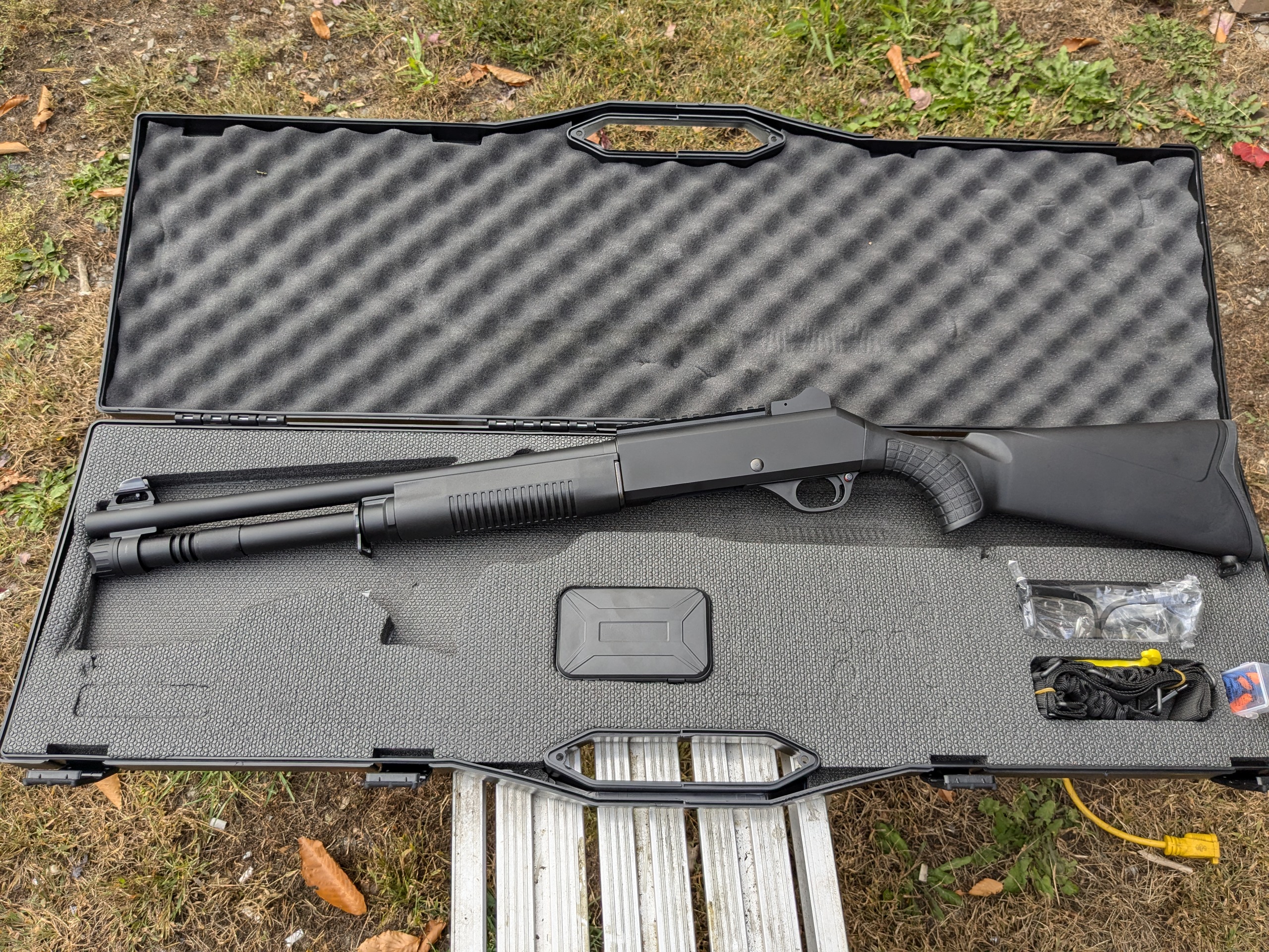

Few pics of this piece of #### lol.

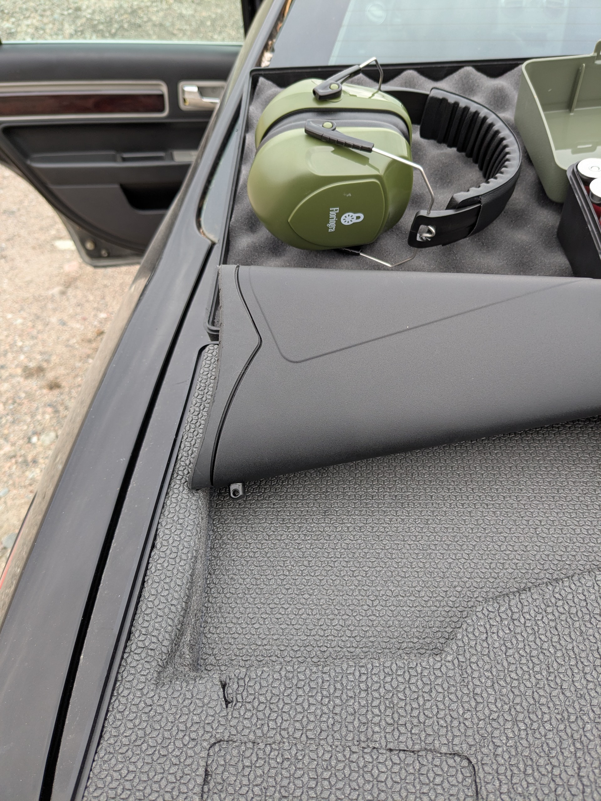

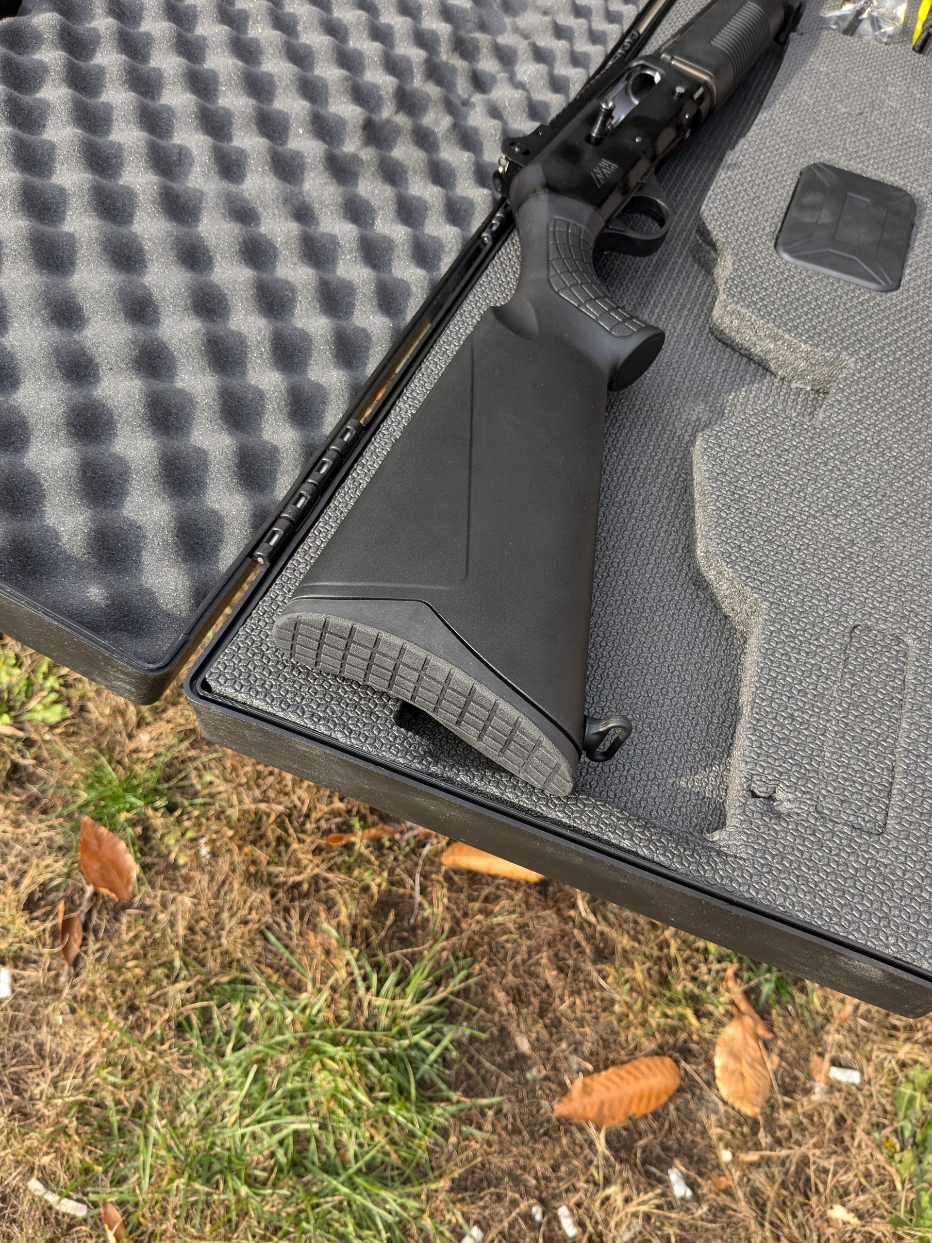

Buttpad again is useless and rock hard, may throw a pussy pad on it so there is some cushion. More useless is the fixed 1/2 sling swivel on the butt, perfect spot for jabbing you in the chest...gonna have to fix that nonsense.
Little O ring on the firing pin retainer pin, guess it helps keep it put. Aluminum follower at least and moves smooth, mag spring is pretty strong, other springs feel "soft/light" to me but I don't know if that matters, seems like everyone throws reduced power springs in real Benelli M4's anyway so maybe I'm ahead there lol.
Case is good, extras are nice, sling is decent, glasses and foam plugs are likely TEMU quality, choke tubes are clean and smooth, but definitely not Carlson quality.

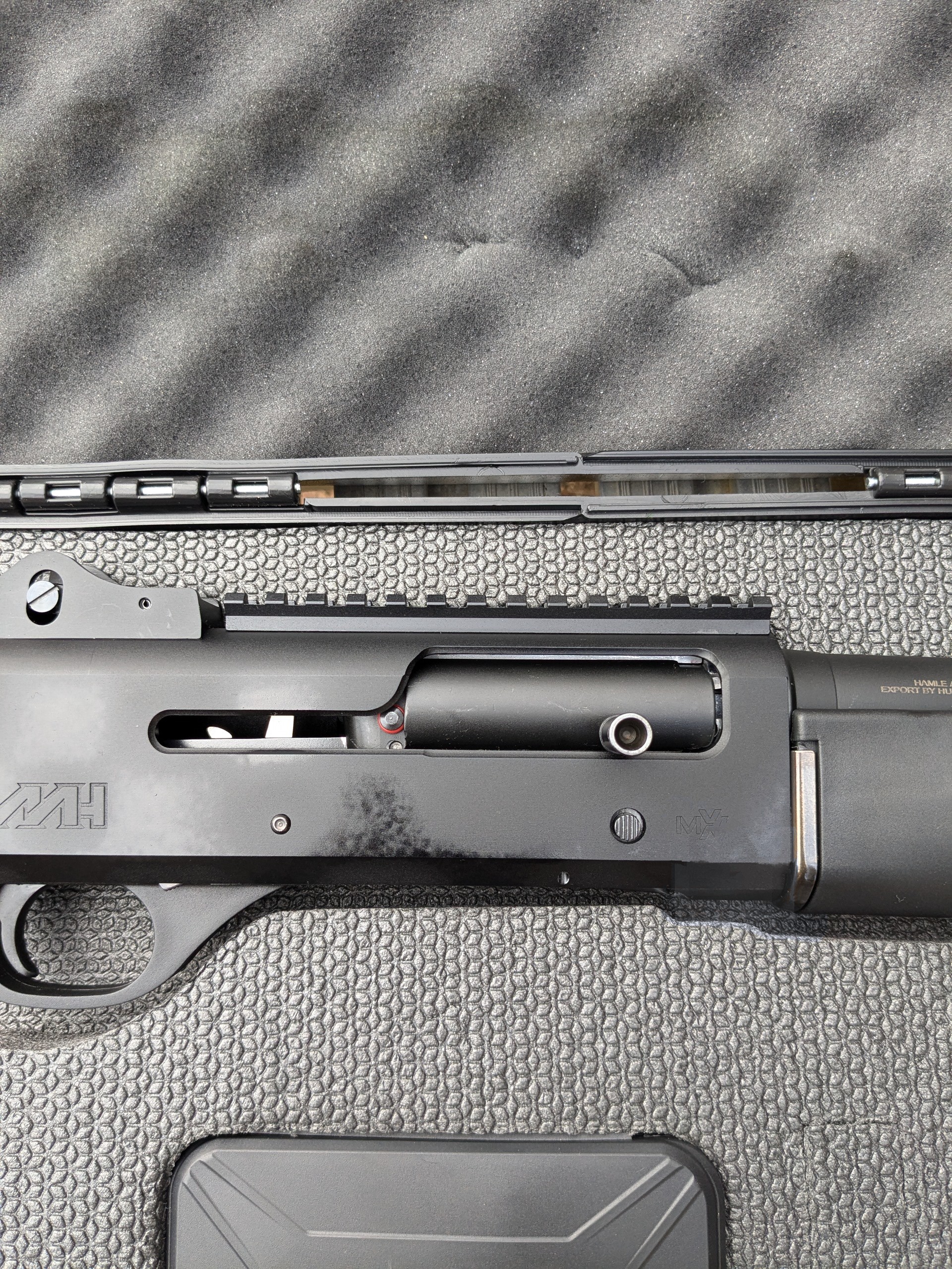

Fit and finish is pretty nice, other then the obvious casted parts braised on the barrel it's all machined 7075 and steel. Definitely looks very M4 cloney, let's hope it works lol

One fail to pick up a round, bolt closed on empty chamber mid way through, one light primer strike on the Federal 7-1/2 near the end of the run. Also noticed cleaning it today it was missing the C clip on the trigger pin bushing that keeps it from wandering and prevents the hammer spring and cap from flying out of the trigger group lol, have lots here so was easy to sort out, may have been part of the issues I had.
It's pretty fun, recoil is mild even with the #### buttpad, fixed it with a regular sling stud for now. Nothing fell apart on it, no bolt or piston peen yet, receiver rails not wrecked, a so I'll keep beating it up, see how long this piece of #### lasts lol.
