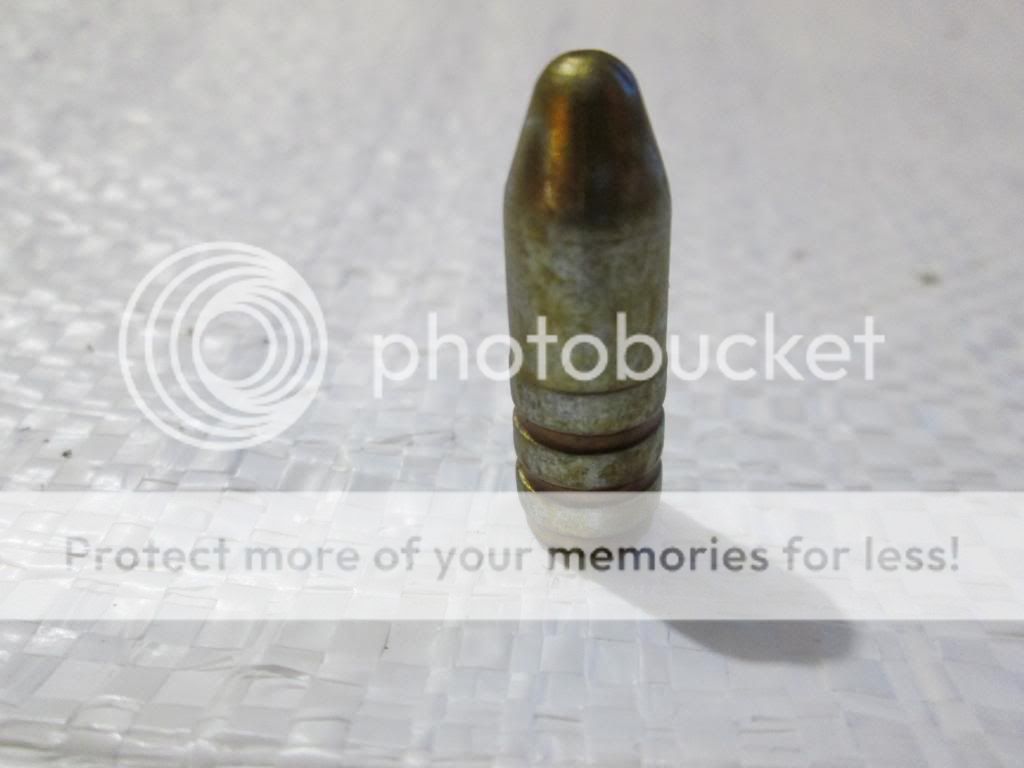

nice clean bullets! what lube do you use?
Please tell us about the J-word bullet. It looks like the ones I swage from 40 cal brass and BT_Sniper dies. If you wet tumble them with copper BB's, they come out a copper colour!
Mike
they look like hornady 350gr XTP bullets to me.
