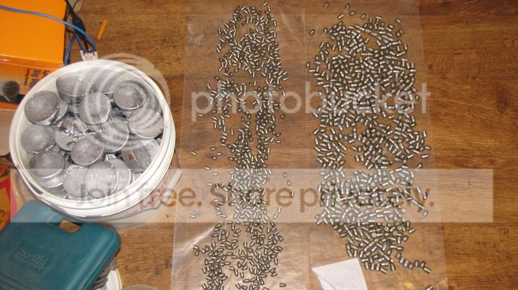

Thought i would run off some 45 and 9mm today
are those lee tumble lube boolits?
how many did you make?
I warm the larger ingots on a hotplate to just below melting temp, they melt quickly when added to melt
Looks like you're using the muffin pan ingot molds. I switched to the the mini muffin pans and prefer them because the ingots only weigh about 1/2 pound each and melt really quickly in the casting pot & don't lower the alloy temp much. You can get mini muffin pans with about 24 cavities so you can cast a lot of ingots in a hurry.
I reversed the base plate on my 10# pot and mounted over my 20# RCBS pot. By doing so I have 10# of hot lead ready to refill the larger pot all the time.I use a 6 cavity LEE mold. After I leemented it the boolit's just fall out.
Now I have to pre melt in my old 10lb pot to keep my 20lb'er working.
To the OP if you buy a cheap computer fan from Canadian Tire ($10.00 locally here) it will help in keeping your molds cooler.

I've been looking for the mini muffin pans but I can't find any that are not non-stick. Does anyone use non-stick pans for ingot molds and if so, are there any probems with them?
Non-stick work fine. Lead doesn't stick to them and the non-stick coating seems unaffected by the molten alloy.
WTF! Were you watching me from space or what. Thats my set up also. Although I have found that just ramming the dry bullets through the Lee sizer works just as well as pre-lubing them.
