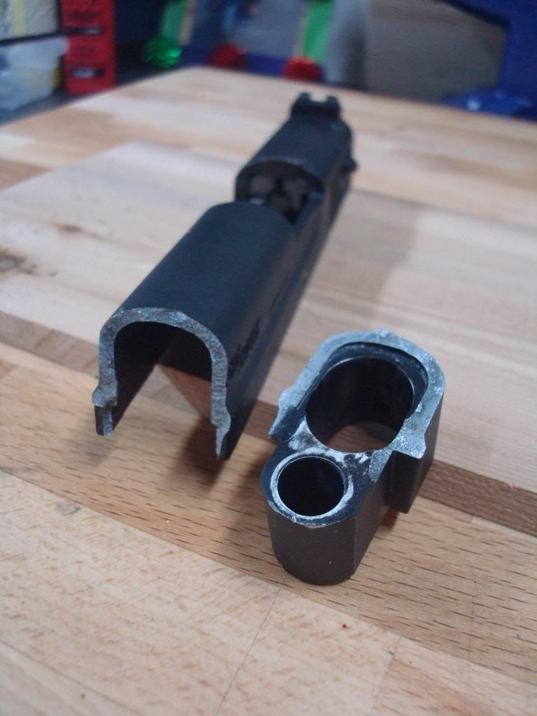

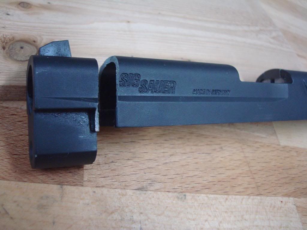

Soooo... This just happened when I was cleaning my gun. Went to lock the slide back and it just kept going. Luckily it didn't happen 2 hours before when I was firing it.
It's a Sig Sauer Mosquito that I have put about 9,000 rounds through. I bought it (barely) used and it's been fantastic so far. Dead accurate, no issues.
Do I contact Sig? Does it go through MD Charlton? Someone else? Is there any chance it's under warranty?
Has anyone had this happen to them before? I don't really know what to do for something this catastrophic.

I knew the Mosquito had some slide issues, but I figured it would just mean excess wear on the rails or something. Not the bloody nose falling off.
Just talked to Sig and they basically told me I was screwed. They won't touch Canadian guns unless they are imported into the US by a licensed importer, and then they have to be exported back. (Worth it for my Sig 1911, maybe, but not a $300 22LR.) MD Charlton is their only Canadian supplier, so off to talk to them...
BTW, the guy from Sig said they recommend the recoil spring be changed every 1,500 rounds to prevent excess recoil affecting the slide. Er... I put a brick of 22LR through this almost every time I go to the range. It's my warm-up gun. So, that's a new spring every 3 or so trips to the range...

Looks like the slide is die cast from "Pot Metal" which is notorious for cracking, manufacturers sometimes make mistakes when choosing how to manufacture things and I think this is a case in point. I only say these things because I have seen numerous failures of a similar nature involving this particular gun. Stronger alloys are more difficult to cast and also cost more, I would be really surprised if Sig Sauer actually made that slide but their name is on it so they should stand behind it.
I wouldn't want to stand behind that slide when it cuts loose
I was just looking into that. Apparently, they are made by GSG.
