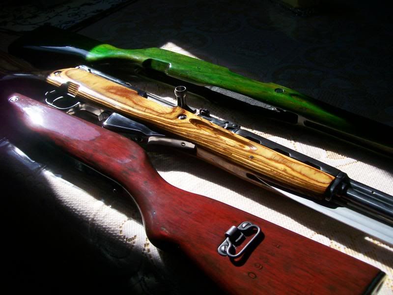

The amount of time spent doing this can really add up. Also, purchasing the materials can add up if you don't have anything around the house already and often it can be cheaper to buy a stock already done. If Lone Ranger's stocks appeal to you, then consider buying them.My stocks take 5 to 7 days. here is a pic of 1 I just finished for a customer.They all have 10 coats of clear. The red and blue ones are for sale."they fit Chinese sks's. I wont do any more,..they are way to much work. if your interested in one or both PM me, or try your luck.
