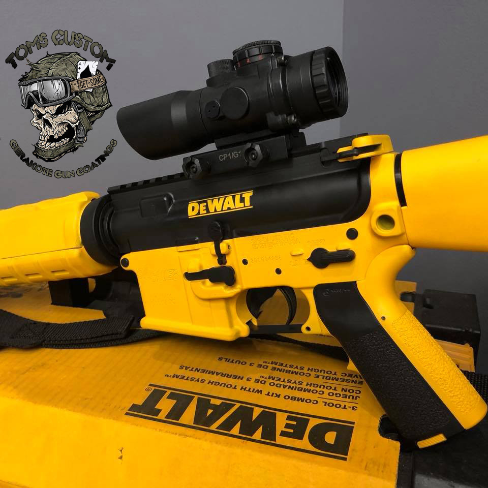

I would have gone like DeWalt Yellow personally
That is better suited to an AR-15
Could be worse.... John Deere Green
