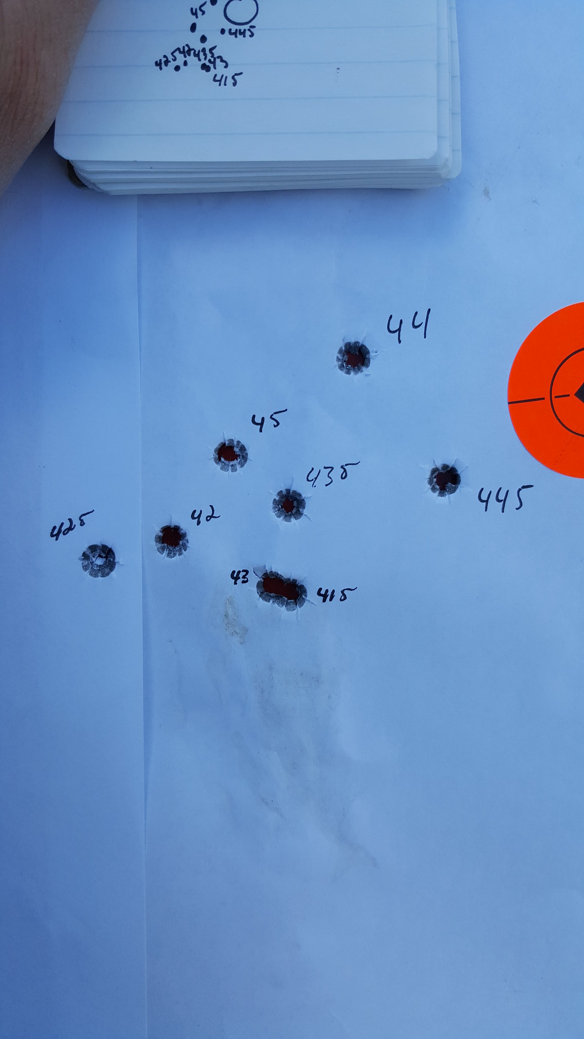

Ok back from testing. You guys analysis is very welcomed.
First picture is ascending test loads at 300 yards. I could not find the 43.5 hit, I think it is in the same hole as the 43 one. 44.5 and 45 showed ejector marks on the ascending test but not on the descending test.
From those results I think I should pick something between 42.5, 43 and 43.5 right? Should I try 5 shots groups with all these loads. Should I discard 43.5?
Im not sure about this analysis. Maybe 43g is the sweetspot that would forgive a bit of scale accuracy if there is 0.1g more or less in the loads.
What would you guys pick and what would be your next step in this load development? Really keen on you guys input.

42.5 to 43.5 imho. First ladder looks nice, have 41-42 lower, 42.5-43.5 middle then 44-45 higher up the paper. Second ladder a little messy, but still has 42.5-43.5 with what, an inch of vertical spread?
I generally do a follow-up ladder, focusing around a promising range. So in this case, I would do 42.4 to 43.6, 0.2gr increments. If you have a chrony, now's a good time to use it.
But you can load up some 5rd groups if you like, entirely up to you.
As for the ejector signs, how quickly were you shooting? If you left the 44.5 and 45gr rounds in the chamber for a while, they can absorb heat from the barrel and shoot warmer then they would if you loaded and fired right away.

Sun came out before the 2nd ladder and mirage started to show up slightly so that might explain the second ladder messyness.
Not sure about how long they stayed in the chamber. I was shooting pretty consistant but the barrel had time to cool off before the second ladder.

Should I try 5 shots groups starting from 42.5 and bumping up in 0.3 increments?
42.5-44
I also look at clusters, not just the ladder(vertical) , horizontal dispersion also means something in my opinion.
Target one you have around an inch horizontal in that load range.
Target two about the same maybe slightly more in vertical.(minus the 44 load)Doesn't take much to throw out a little flier and with only one charge weight we blow that shot.
You are onto something there.
I wouldn't waste on groups yet unless you are very confident in what you have produced.
42.5 , 42.8 ,43.1 ,43.4 ,43.7 ,44 ,44.3. Load em up twice, shoot two ladders , report back. :)
