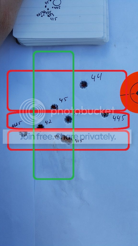

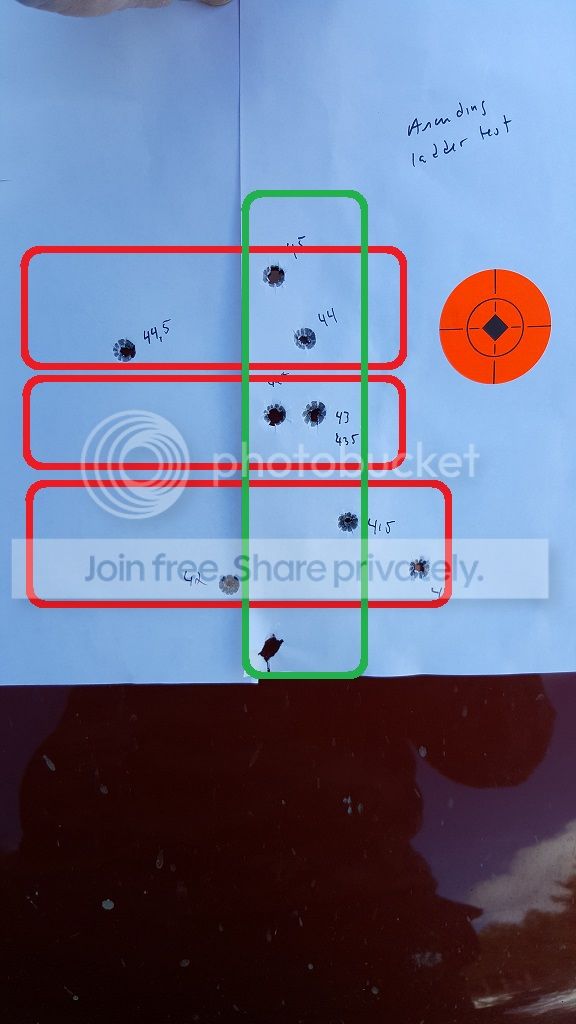

Borrowed my friend OAL gauge and got my measurements. My next 2 test ladders are already loaded and the bullet is quite far away from the rifling. Should I load up another ladder using the same powder loads but moving the bullet 0.050 from the rifling? Im above 0.100 at the moment and I read the TMK work well between 0.070 and 0.020.

I like to find load at book.length then bump it out by 0.010 to find the sweet spot then 0.005 to fine tune even more.
And without a chronograph pointless for determining a long range load...
Not necessarily. I developed the load for my 6.5x47L without a chrony, and it beat the 1/2moa at 300m challenge. Is a chrony useful? Absolutely. Is it a requirement? Not really imho.
Not at 300m so much no, but for long range shooting you need velocity, and you don't know that without a chrony. OP is running 2-4 grains under max with his "sweet spot". Personally I wouldn't pizz around with a ladder test at min loads with long range bullets like 175tmk's. You will just have to redo it all again, with a chronograph.

what you'd suggest then with my current data and now with knowing my distance to rifling? I don't want to waste bullet because after this lot I don't have anymore TMK's. Trying to source some at the moment.
Should I just bump the bullet to 0.020 from the rifling and do group tests?

If it was me playing around, I'd use minimal neck tension, seat them long and into the rifling, let the rifling seat the bullet in the case, shoot groups.
