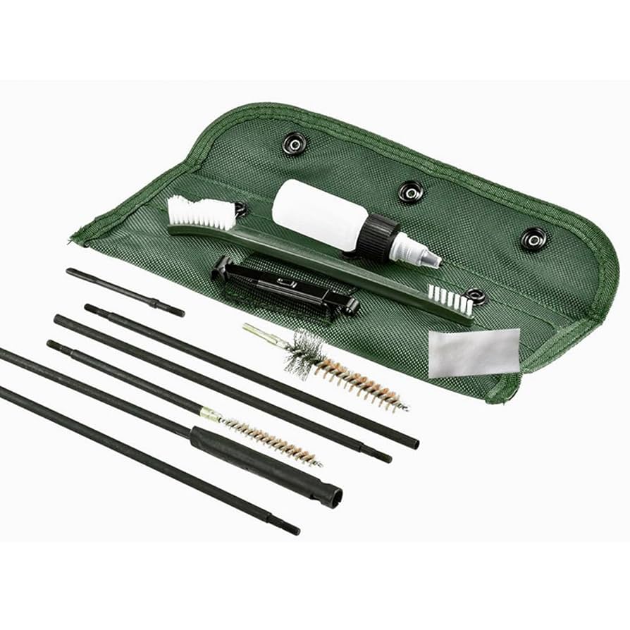

If one just absolutely has to have a means to clean in the field, spend $20 and get one of the reproduction US Mil M16 cleaning kits in the green nylon case.

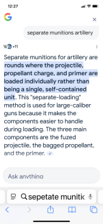

I guess you never heard of separate munitions. By your logic there would be lots of screwed up cannons in Ukraine.
Separate Munition in Artillery​
Separate munitions in artillery refer to ammunition that is loaded into the breech of a gun in distinct stages. This method allows for easier handling and transport of heavier shells and charges, especially in large-caliber artillery. The components of separate munitions include the primer, propellant, projectile, and fuze, each loaded separately before firing. This approach enhances the efficiency and versatility of artillery systems, allowing gunners to adjust the propellant charge for different ranges and target types

Good Lord, it would appear that you have HEARD of “separate munitions in artillery” but don’t understand it if you think that it is relevant in any way to this subject. At any rate, my posts are more for others that are reading this so nobody tries your dangerous suggestion. For the record, you were right about one thing, I had never heard of “separate munitions” before so I looked it up and this is what I found “feel free to show how this is relevant to the topic at hand IMG_2826.png

The small arms equivalent of the separate projectile/separate powder charge used in larger artillery is the breech seated or muzzle loaded projectile with a charged case loaded behind it, popularized for target shooting in the late 19th century. Harry Pope, among others, used this system very effectively.
This has nothing to do with using a blank load to shoot out an obstruction lodged somewhere in the bore.

Good Lord, it would appear that you have HEARD of “separate munitions in artillery” but don’t understand it if you think that it is relevant in any way to this subject. At any rate, my posts are more for others that are reading this so nobody tries your dangerous suggestion. For the record, you were right about one thing, I had never heard of “separate munitions” before so I looked it up and this is what I found “feel free to show how this is relevant to the topic at hand View attachment 1026188
