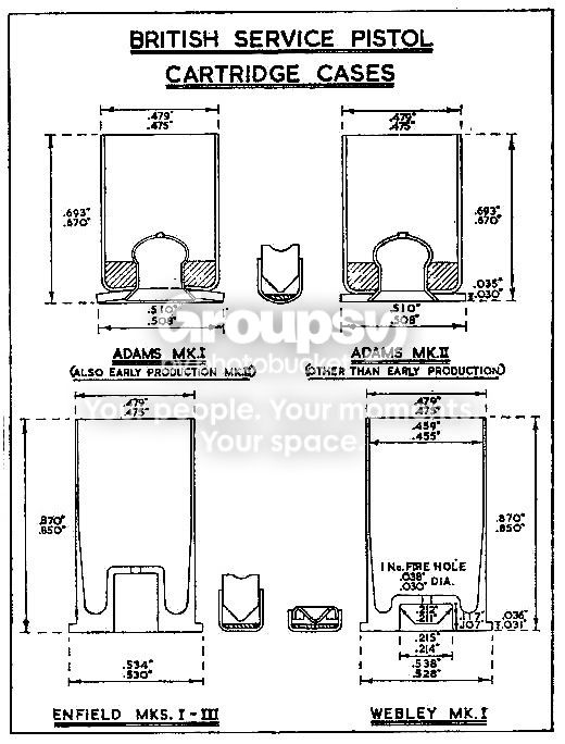

Despite the confusing nomenclature used by the British, all of their 19th Century service revolver cartridges (.450 Adams, .476 Enfield and .455 Webley) had the same effective bore diameter and used .455" bullets (with the sole exception of the Mark III Enfield bullet, which was a "heeled" design with a very short ".476/.477" section). In fact, when its adoption was documented in the War Department's "List of Changes", the Enfield was referred to as being of .455" calibre .... not .476 as some later began calling it. Any other revolver chambered for one of those cartridges, such as your British-retailed Colt, should have much the same requirements for cartridge case and bullet diameters .... and ".455" and ".476" revolvers should chamber and fire cartridges designated as either, equally well.
Here is a diagram giving original British War Department cartridge case dimensions -
Note that the case-mouth diameter is the same on all of them (even though only the Webley Mark I diagram also gives the
inside diameter ....) As for overall case dimensions, note that they are essentially the same for the Enfield and Webley cartridges.
Similarly, note that the effective bullet diameter for
all of these service revolver cartridges was .455" -
