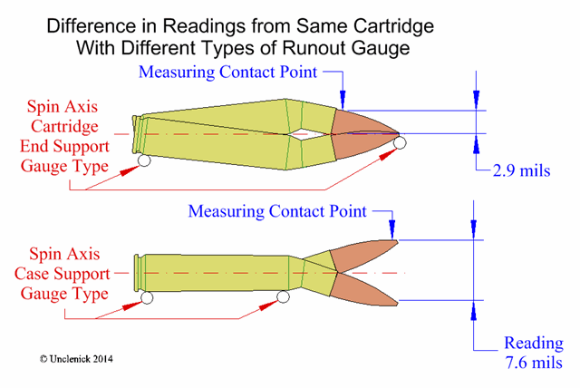

With a neck thickness and runout gauges you will find out "why" you have runout and how to fix it.
1. Resize a few cases "without" the decapping rod in place and check your runout and neck thickness. Next reinstall the spindle/expander button and check your runout.

NOTE: The U.S. military match grade ammunition is to have .003 or less runout.
