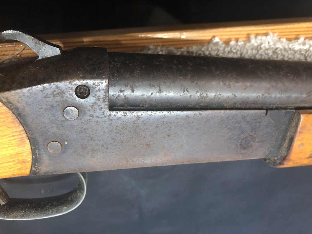

Well the barrel is actually in pretty good shape after cleaning it. Other than some marks that’s I’m unsure about don’t know if there manufacturing markings or what lol

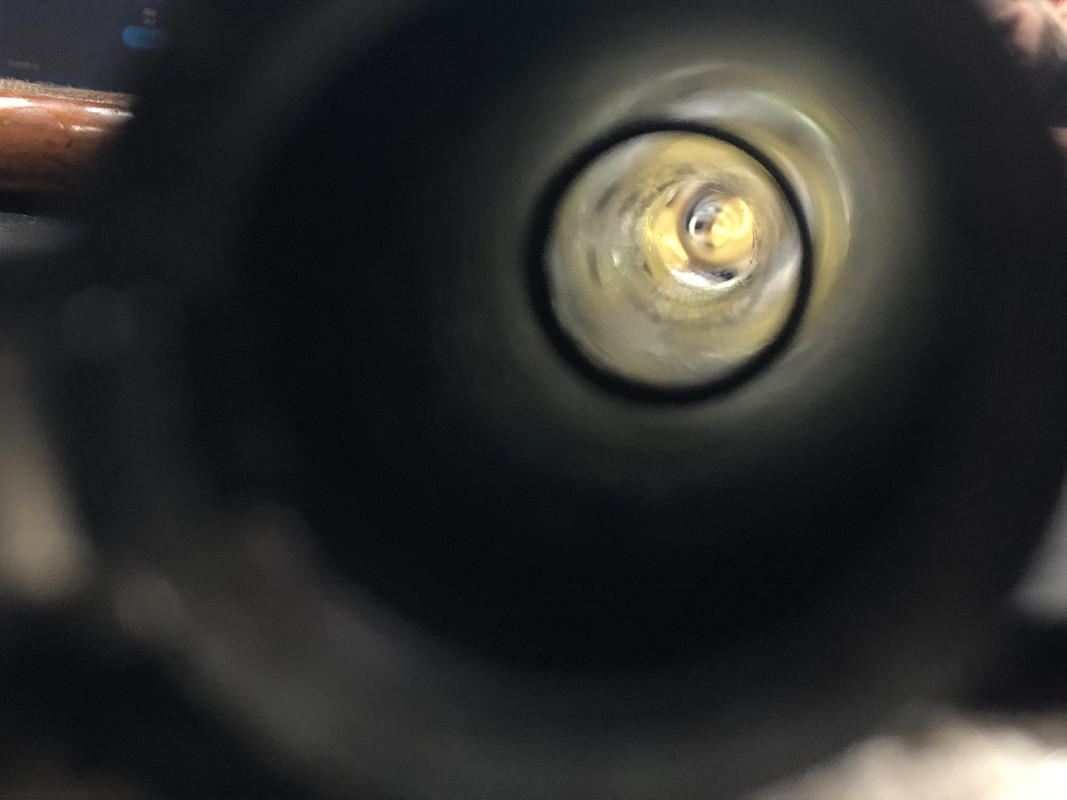

Well here is some pics of it, also you can see inside of barrel wasn’t too nice. All is good and clean and shiny, hard to get a proper pic to show it.
She’s rough but I bet things will clean up a lot with some steel wool and oil, wtf is with the gouges down the barrel? I mean it’s just a smooth bore but that ain’t right.
Yes exactly my thoughts too when I seen them. Don’t know if it’s a manufacturer thing or what lol
The marks appear to be in the forcing cone - is a tapered area between chamber and barrel, I think. As if someone tapped in a metal tube or a metal bolt to clear something out of there?? Most of the shotgun barrels that I look through should be shiny clean - chamber, forcing cone and barrel - spotless - like a good mirror.
