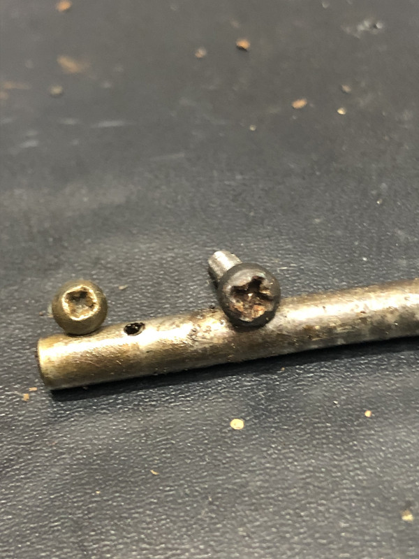

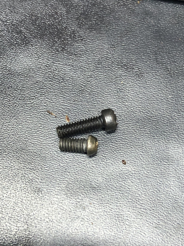

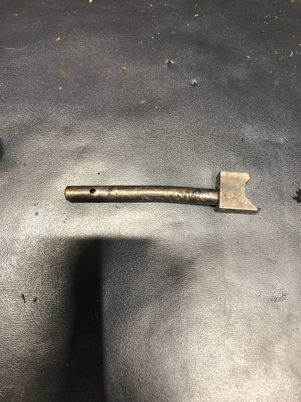

Well I’ve got it all apart right now and have some parts soaking. All though could someone confirm if the pic here looks right then or is this piece bent from abuse ? Also these two screws have seen better days. So glad I got them out out lol, where can I get a replacement for them ? The smaller one is the trigger guard. The other is for the firing pin it goes in the side of the action/case
