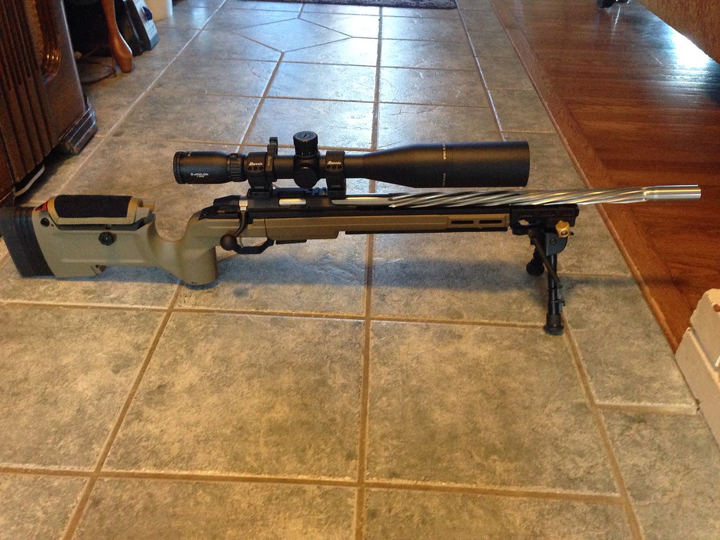

I concur after having built a rifle from a T1x (IBI barrel, KRG Bravo chassis etc). The T1x mags suck to be honest and 2 of the 5 I have cause feeding problems.
Were I to build another it would be from a 457 (I have 2 x 455's but like the bolt throw of the 457)

Failure to feed when the round comes up at too much of an angle into the chamber. This seems to be a 'known' problem with both the 22LR and 17HMR (my hunting buddy has a 17). Some people have done some mods on the ejector wire.
From what I have read on a couple of other sites ref this issue Beretta knows about it and it is one reason the Left hand T1x has not been released - they are waiting to sort out the mags first.
http s://www.rimfirecentral.com/forums/showthread.php?t=1198249
http s://www.rimfirecentral.com/forums/showthread.php?t=1187099
http s://www.rimfirecentral.com/forums/showthread.php?t=1194577
http s://www.rimfirecentral.com/forums/showthread.php?t=1204915
I really love the rifle but based solely on the mag/FT feed on occasion I would use another receiver next time, probably the 457 for the short lift bolt like the T1x has.
