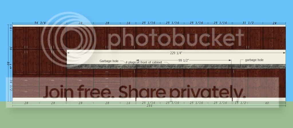

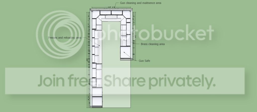

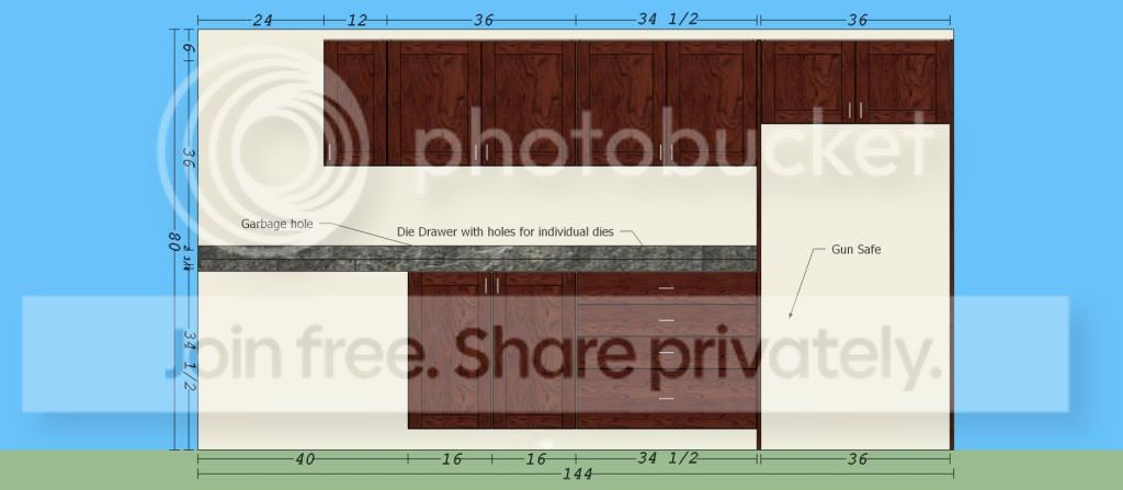

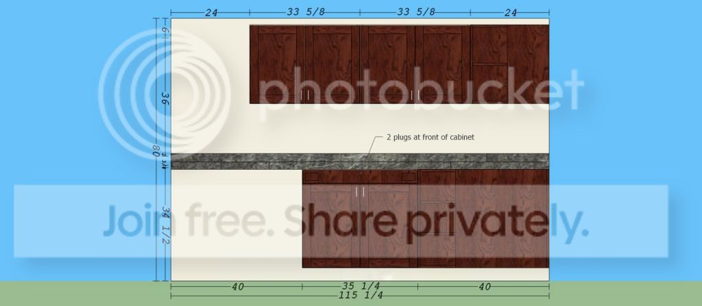

Update: Room is now dry walled and painted tbar ceiling is going up and electricians are doing most of there work tomorrow. I did put in a few exhaust fans like someone recommended as well as tons and tons of lights. if I had any windows in my basement I think you would see the light from space. here is my final design for the cabinets with some measurements and notes to show where things are going.
The only issue with this is that it'll cost you so much more than your original estimate. Once the wife sees how nice it came out there's no way you'll avoid re-doing the kitchen as a followup act.... :d
You won't regret the massive use of lighting. The work area I've got is not far off yours other than for no pantry closet sized units. I've got a continuous end to end row of 4 foot fluorescent lights in a big L pattern over the working area and it's just right. And the tape on LED lighting under the cabinets does fill in the shadows just marvellously.
Even with that I've found that aging eyes do not see details when looking into dark places with any short of shadowing. So I've got a few LED flashlights dotted around the area for looking down into the darker recesses of the guns. I've even got a couple of the strap on headlights to use now and then when I want the extra light but also need both hands free.

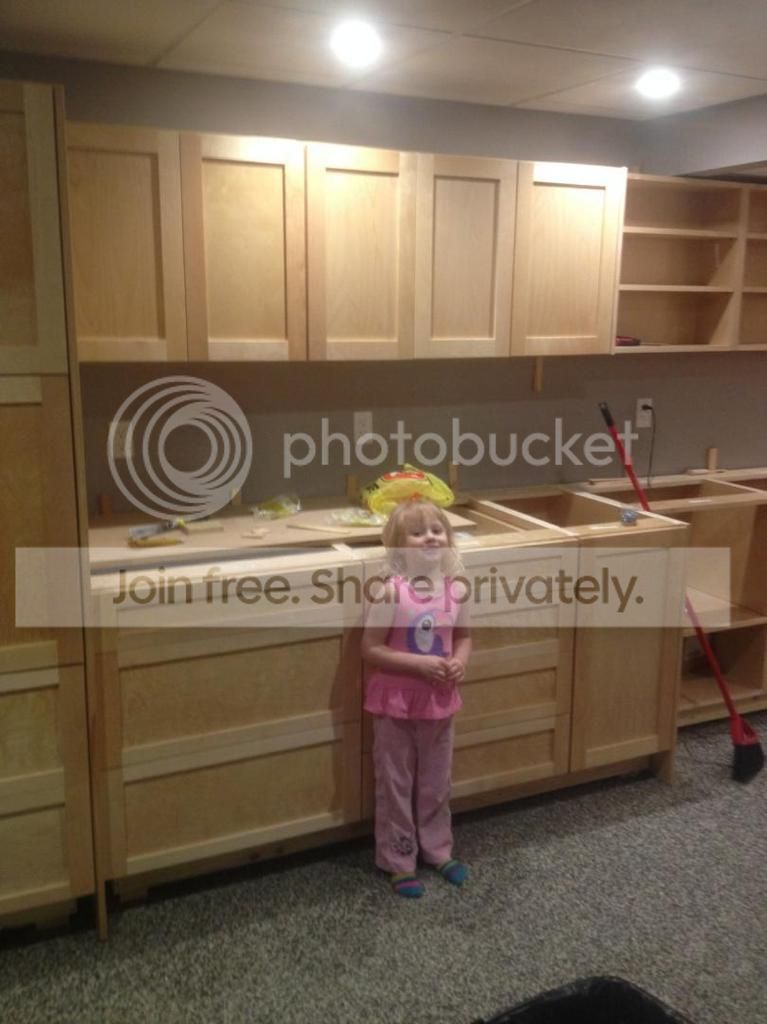

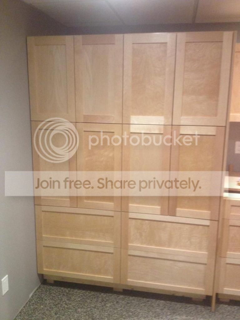

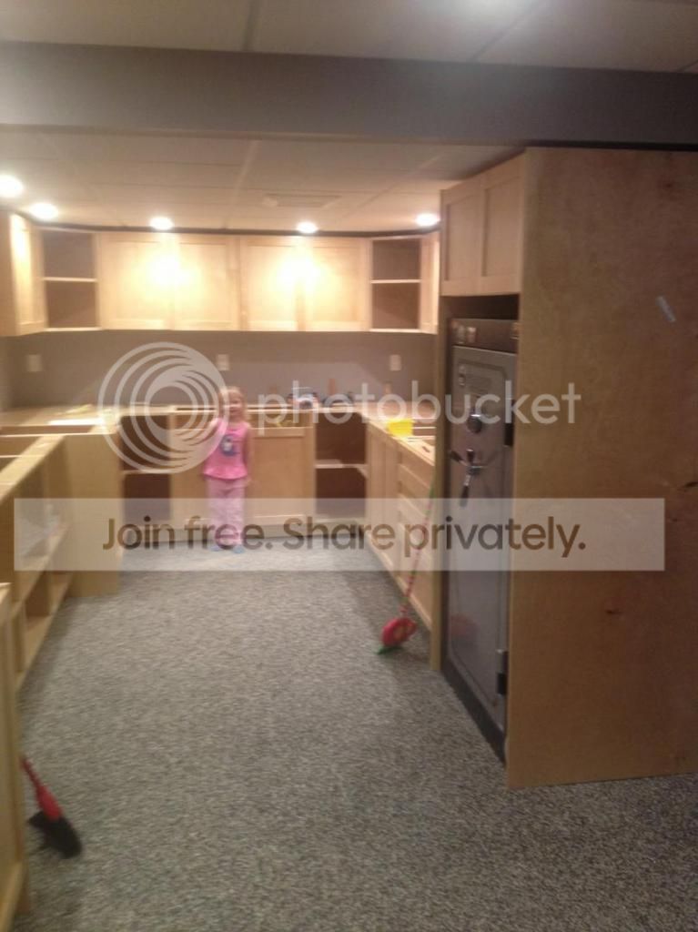

Well guys unfortunately it took me way longer then I had planned but Im making progress finally. Had some CNC issues that delayed me a couple weeks. The cabinets are in now I will be doing the tops after I get back from a wedding that I am going to. Here are a few pictures. My daughter insisted in being in them.
