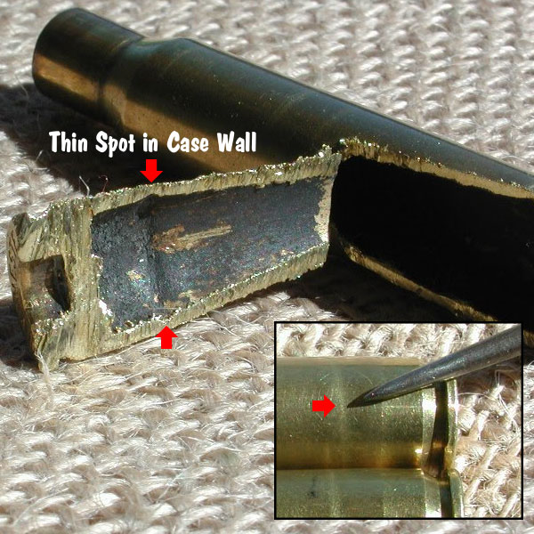

Sharpen a piece of wire and bend it at a 90 degree angle. Insert it through the mouth of the case and drag it up the inside and see if it catches in a groove just above the head. If there's a groove, toss it. If there isn't, you're GTG. I use a dental pick.

Absolute thickness is not really important. What you are looking for is localized thin spots (which indicates the brass has yielded and "necked" at that location) or cracks.
This picture taken from here shows it:

I did the bent pick trick. found no ridges or any kind, all smooth.
what I was measuring was the thickness of the area. they were consistent around the case in that spot.
I don't see any visible signs that concern me.
