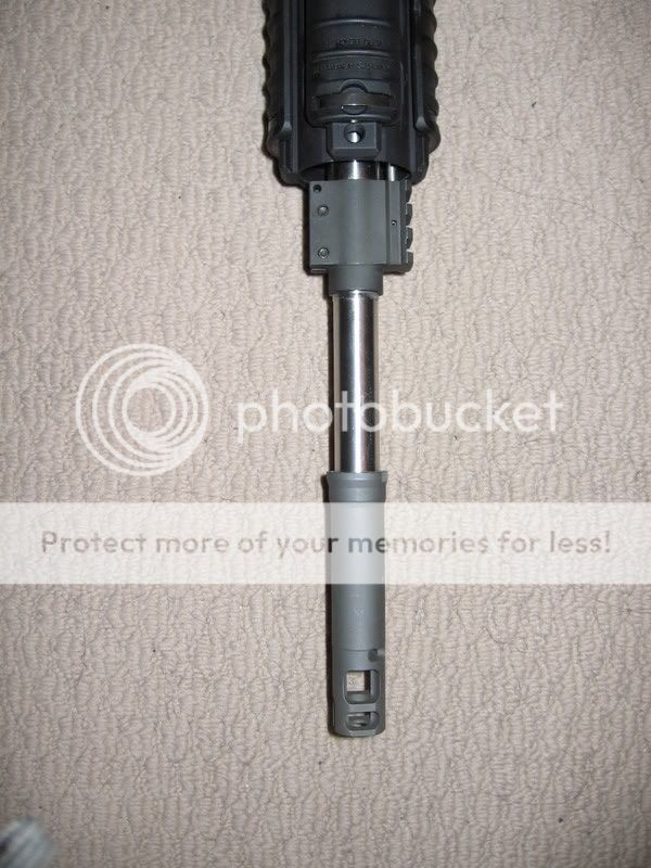

This was Friday ar10T, my latest project in cutting down part of the barrel to accommodate muzzle break.
That is pretty awesome looking. And I am a huge fan on the extra noise! I am trying to go to a very short upper and then get a 20 inch T upper so I have the best of both worlds rather than the intermediate length upper thats a little too long for an entry weapon and not quite accurate enough for a highpower scope or bi pod.
It shoot very nice at the moment, for a heavy gun like the Ar10T to have a same recoil or less than 223 is quite amazing, as the hammer go, there is slight jerk and I could see the bullet going down range to the target, and with my 20inchs barrel ar15, it went quite well with 77 and 80grain BTHP. out to 500meter at the moment!
