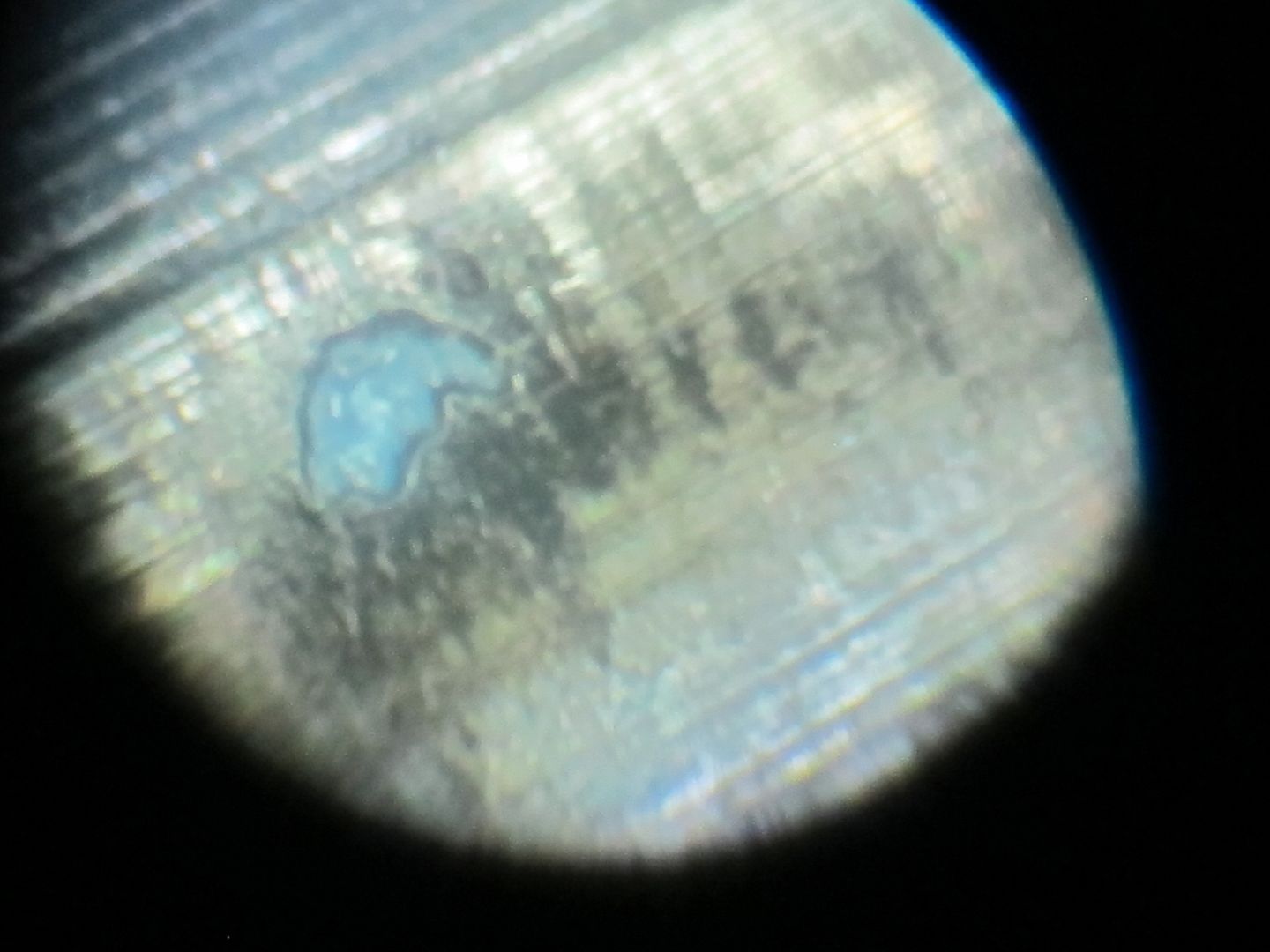

I'll show ya some chamber crap I had once after shooting only 100 Remington Thunderbolts, pictured after two scrub sessions with a bronze brush and soaking overnight in solvent. Big lead speed bump in the chamber, just ahead of the case mouth. Stuff like that is gunna put pressure on a chambered round and tilt it out of alignment with the bore hurting accuracy. Soft lead grows and mutates with every shot so the next round gets a different amount of pressure and tilt put on it, no consistency. Bye Bye accuracy, the JB bore paste was needed to remove it. Better ammo has never fouled up my rifles like that Thunderbolt did.

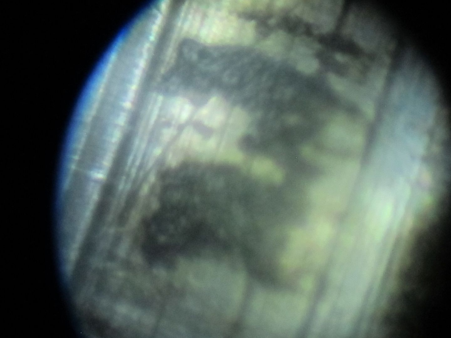

More remnants of the carbon ring before it got the paste. 100 rounds, I can only Imagine the 2K buildup!
