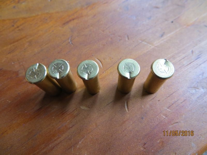

Photobucket is having issues tonight, so no pics right away. I do have before and after pics of both cases and the firing pin itself. The mod took about an hour and a half and a dozen tear down and reassembly cycles of the bolt.
If you remove too much material, you're replacing the firing pin, better to take off a little bit then try it.
Some have better success than others. If your rifle has no ignition problems in the first place, you won't see any improvement. Mine apparently did, although the only indication was inconsistent shooting, never a fail to fire in over 1000 rounds.
If you look at firing pin imprints from high end 22 target rifles, i.e. Walther or Anschutz, it'll give you something to work toward.
The CZs are particularly prone to this IMO, I think they use the same FP profile in all their rimfire bolt actions, regardless of caliber. I may be wrong about that, too.
Ronnie is spot on with his comments above. If you're going to try this, or any mods for that matter, try one change at a time, then shoot the rifle for a while to evaluate what effect it had, if any.
I never would have suspected it would make any difference at all until I started reading about other's experiences. It definitely changed the 452 I have for the better. Once I have some more results from shooting 50 to 100 yards, I'll change my 455 to match the 452. 25 yard results show a definite improvement, and initial testing at 50 looks better too. I don't base my decision on group size only, but rather on scores from various targets I've shot before. None so far have been the same or worse, all have shown improvement.
Maybe pics over the next few days, time permitting.
