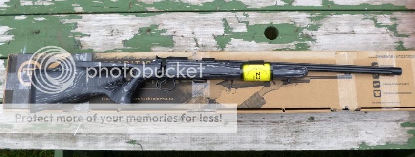

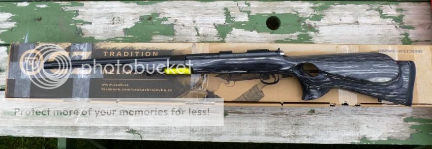

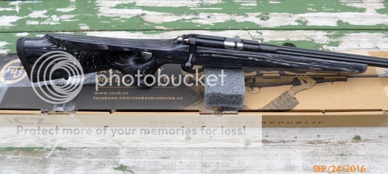

I think the rings at this particular time were inexpensive UTG medium 30mm rings to go with the inexpensive Mueller 8-32 scope. This rifle did the 50 yard challenge as did my 453 Varmint in a black Boyds Pro Varmint stock.
As far as the Boyds black vs coloured laminate, of which I've had both, as well as the solid walnut, I prefer the coloured laminate Pro Varmint stock. With a standard comb and standard finish, in July of 2016 the one in the following photo for a 455 Varmint cost me $263.35 (CAD) all in, delivered to my door.

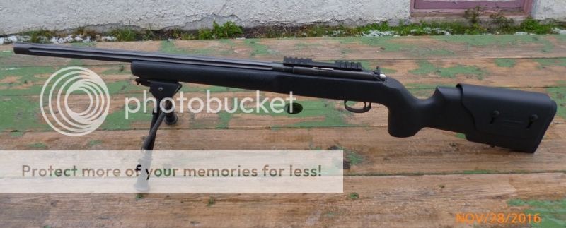

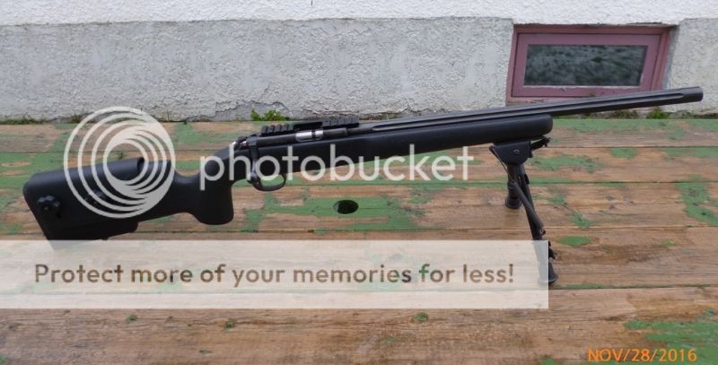

ok I have a few pics -- this gun is now all DIP dipped up. I have the trigger down too OZ's ( hair trigger ) passed bump tests used DIP adj sear with YoDave kit.
DIP - 25MOA rail extended
DIP - extended mag release
DIP - Aluminum mag well
DIP - Adj. sear
YoDave kit
YoDave 10% heavier firing pin spring
Waiting for Tactical Bolt handle from across the pond
I still might part with this stock Boyds Pro Varmint for a MDT LSS chassis
awaiting 30mm rings for my SWFA 16x scope I'm mounting on this rig. can't seem to find a set I like.
