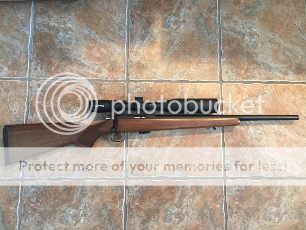

I have just received.
Unfortunately could not spend more than 10 minutes with it as i have too many things to do tonight.
1st impressions, bolt is nicely machined and real tight, the blueing on action and barrel is gorgeous.
The stock is meh. Plain wood with nothing special, comb definately feels too low, scope will confirm.
As far as scopes go change of plans. I want a dip rail to use standard rail rings, as i want to test my other rimfires with same scope bit wish to mount scope to rings only once.
Edit, it was stronger than me, i had to strip it and examine.
I hate having firearms shipped in the winter, so took the stock off, and wiped all the metal everywhere with a thin coat of G96 and wiped off.
Saw on rimfire central forum, that lots of people torq action screws to 22#, so i did just that while reassembling.
It's confirmed i have an 11mm rail, still thinking of dip rail so i can use scope setup on other build if i want to quick switch.
Only concern, i cleaned the bore with my Otis system, breach to muzzle, and first patches we're rusty brown.
Either they used a bore protector paste thats rusty in colour but unlikely. The lands are nice and shiny, brown stuff comes from the grooves so hoping it doesnt affect too much

And once i have mounted scope in very early january, pictures and a range report will follow, can't have a long thread like this one without pics!
Congrats on your new CZ; I have the exact same version (452V) and also have those same CZ rings mounting my scope. FYI, mine is one of those 452s listed as successful in the .5" challenge. That was without much effort, by the way; wasn't intending to shoot the challenge. Was just trying out Rem/Eley Target and the groups were all pretty consistent so thought I would see if I could finish up successfully. I just squeaked by but am very confident that if I was using higher end target ammo, I could better my results. Those groups were shot on the second visit to the range with that rifle, BTW.
Also, FYI, my scope maxes out at 8X, and is a Leupold VX3, with parallax set at about 100 yards. So I always wrestle with parallax at 50, but just try to be consistent. I've made no adjustments to my rifle as it came out of the box, and I'm very satisfied with how it shoots. You probably will be as well.
