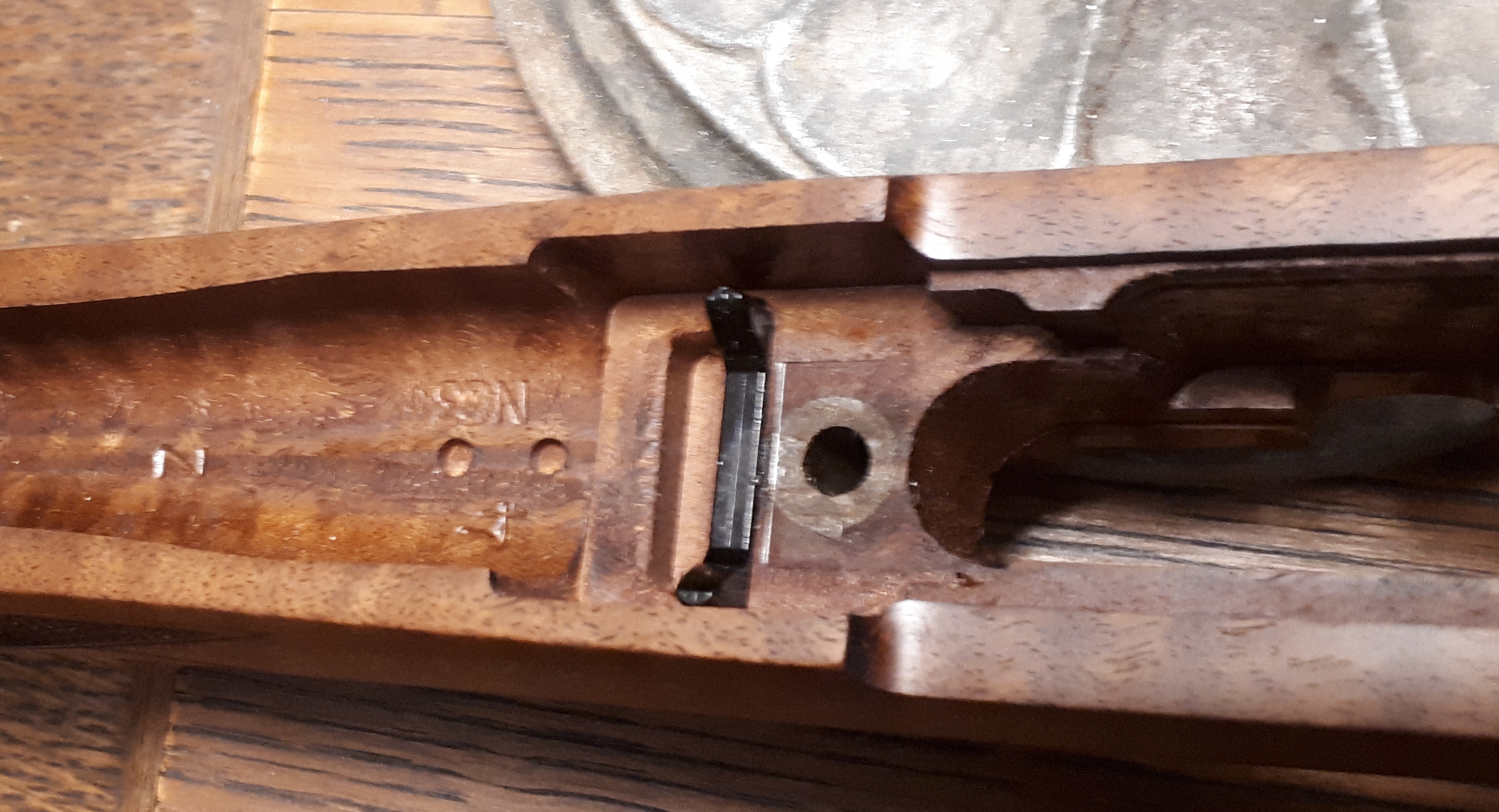

New wood CZ has this bedding set up, seems to work, haven't blown mine up yet.

So the "revised" stock has two recoil lugs or just one? Did the recoil lug get added the same time they changed the sights? The rifle I'm considering has what I believe are the older version of the open sights. The rear is at 90 degrees from the barrel, not slanted back like the new sight. Front sight is a very fine bead I guess you'd call it?
I severely doubt they'll let me take the action out of the stock to check the recoil lugs. Lol
Sights I believe were changed before the stocks, 527 basically got the 557 sights in an "upgrade" if you want to call it that, stocks came after that.
So if it has the old style sights, probably has the old.style stock, but if the guy shot it and it didn't crack, it's probably fine.
It's not really the front recoil lug causing the issue, it's the rear tang coming in contact with the wrist, same problem that happens with any old school Mauser and easily corrected.
The new style sites its the front site that is a complete fail...its plastic...fibreoptic....has a uber tiny allen screw to hold the flimsy plastic site which rockers in an eccentric arc to adjust...it is a miserable lil piece of crap....a poor answer to a question not asked.
The older front site was steel and not adjustable....
The 762 rifles recoil harder than the 223 ...which mostly dont suffer from the cracking issue.
And yes as mentioned it is the action tang that contacts the wrist and cracks it...avoidable yes...IF one was aware prior to it occuring...which a lot of us didnt before we ended up with cracked stocks :(
Yes it can be addressed with fairly easy approach before it cracks...depensing on ho bad it cracks it gets ugly afterward.

I had the crack and I'd rather buy an older model still tbh. I like the gusseted magwell and older fixed sights.

A YouTuber named John Capps put out a video outlining the issues he's had with his rifle. He has the "revised" version with the new sights etc. Not sure if his rifle also has the newer recoil lug setup or not (seems likely), but he also bedded his rifle, and it still did not prevent the crack from happening. I'm not sure what to make of that. Perhaps it's the combination of bedding, plus relieving wood around the tang that needs to be done to prevent the crack.
I'm a bit shocked that despite how popular these rifles were, in combination with just how common this cracking is, that no one jumped in to capitalize on the situation by putting out an improved stock. Even a simple, inexpensive synthetic. I don't like the Boyd's AT-one at all, but it looks like that might be the only option in an aftermarket option.
I've put over 1,000 rounds downrange in my late model CZ527 and the stock has held up just fine. I had heard of some of the CZ big bores having their stocks crack in the 550 line, never the 517 so thats news to me.
