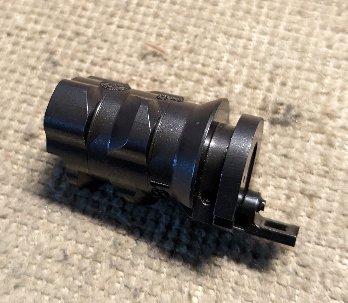

Put up a photo. I'd like ti see it. Also, can you post a photo of the firing pin?
Here you go...scope mounting, dinky firing pin, huge mag and how far the cartridges can slide around.
More goodness... extractor spring is a straight wire, pics of the bolt lugs, pretty tiny and with the cams machined into them only about 1/3 left for actual contact. I'd bet the entire surface area of the 6 bolt lugs that make contact add up to less area then 1 lug on a 2 bolt lug...
Thanks for posting those pics. I wonder what an M98 pin looks like next to the 600 pin. From the photo, it appears quite standard. Interesting observation regarding the locking lugs and you're probably right. On my 577's there's also room for the rounds to slide around but I've always made sure to avoid short stroking.
I should have used something for scale, but it's dinky, only other one I've seen similar design is Tikka firing pins. I have no idea what that lone C clip is doing on there.
I'll take some pics with it and a few other pins, 700, 98, Howa, Browning, they all make this look like a toothpick lol
