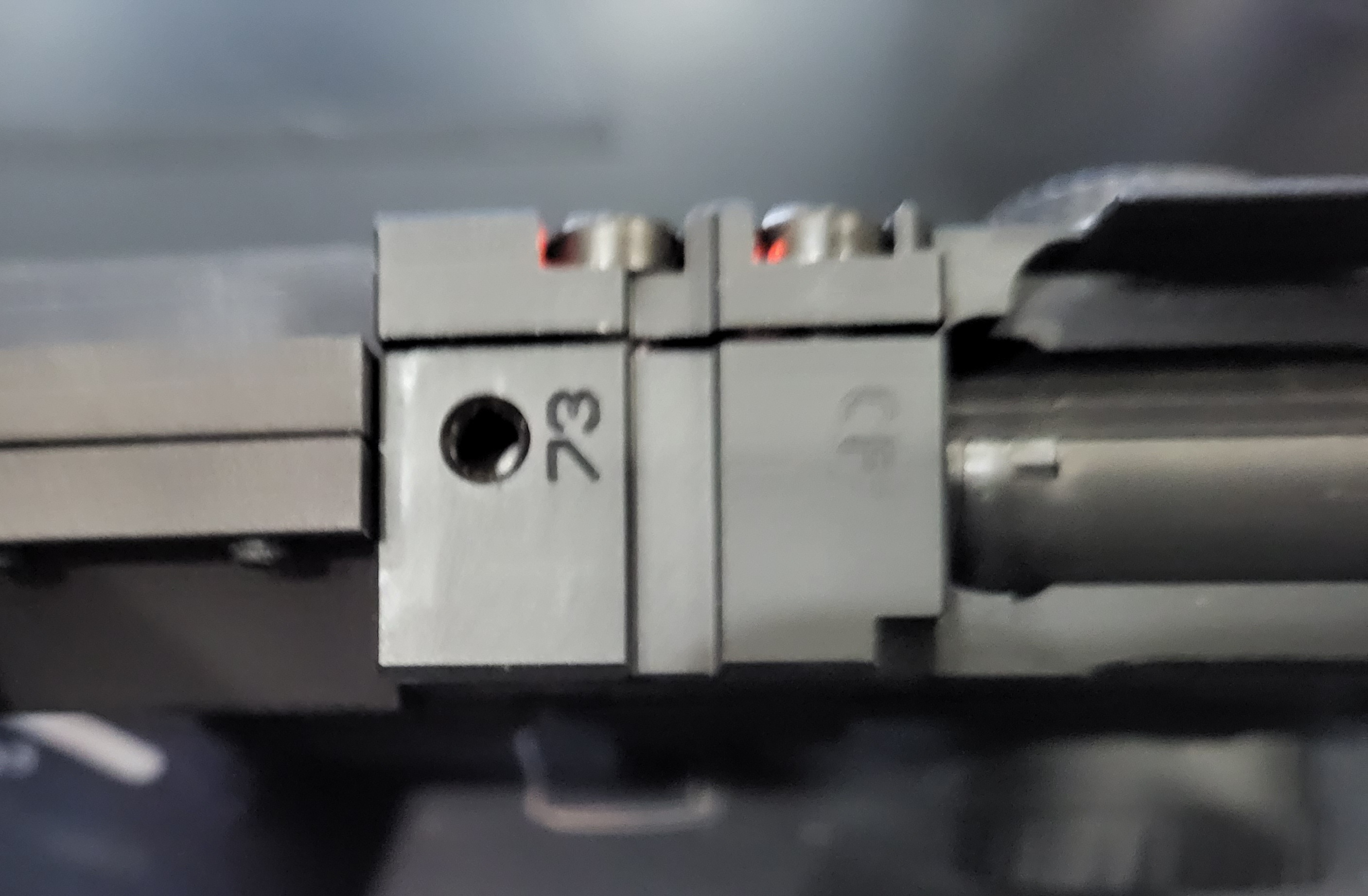

Do I understand correctly that the forend is only attached by clumping on a plastic friction ring over the barrel and then receiver connects to plastic lower by 2 action screws only so forend is hanging on just a barrel, is that so?
Yup, You've got it. Good to know that my explanation was clear. Better yet, the Barrel is held into the Receiver by clamping force based on the 2 Barrel Tensioning Screws. And still, despite a quick-change Barrel design, it shoots sub-MOA with the very first factory load that I tried....
