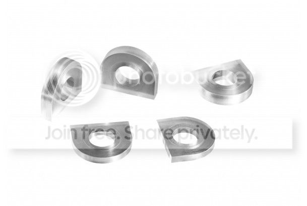

After all the recoil buffer talk I decided that I need to try one in my CZ 75B Shadow Line so I ordered some from Dlask and they came today. Just for reference my gun has the slide without FLDC, the slide does not have a hole in the front for the recoil rod and the rod is very short. Now for the questions, I can not figure out which way to install the buffer, yep I get that the flat edge goes toward the barrel but I can't figure out which is front and which is back. It is completely flat on one side with a protrusion on the other side.
The buffer, as is will not work, won't allow my slide to go far enough back to engage the slide lock. I know that CZ europe does sell buffers for the CZ 75 Shadow Line but perhaps they are thinner. I could sand the protrusion off and try it like that but not sure I want to mess with it if isn't going to work.
The other thing I can't figure out is how or what the buffer does, it does not seem like it can ever come in contact with the slide or frame and to me it just seems like it would cushion the spring? Please note that I am new to CZ's so please have a little patience with my perhaps silly questions.
Ok I have done a little more digging on the CZ europe site and they do indeed have different buffers. On the left is the SP01 buffer and is what I got from Dlask. The ones on the right are what they show for the CZ 75 Shadowline. From the picture it appears that it does not have the protrusion that the SP01 has. It's kind of hard to judge the thickness and I am still wondering if I should try sanding one as an experiment?
Since this is related to the recoil buffer, what do you think about shortening Recoil Rod Springs? I ordered an 11lb and 13lb from Dlask and I will have to shorten them in order to use them as they are both 110mm longer than my stock spring, plus add in the thickness of the buffer.

For the SP-01 Shadow the smooth side goes forward.

And, actually CZ has addressed this with the new Shadow 2. As explained to me by the lead engineer, better concentricity of the slide stop hole results in less breakage, along with some tuning of the holes edges. It will still break, as it is a wear part, but will last longer.​

The shockbuffs do a ton to help stop them breaking at lower round counts and the newer generation of stops last a lot longer.​

it's not needed if you don't mind breaking slidestops and causing unneeded wear and tear on your gun. All the new models are shipping with them, that says a lot​

I broke 5 slide stops in my first Shadow. Round count was about 50,000 when I sold it and it's still running strong. I used 13 pound recoil spring shooting mostly BDX reloads with no shock buff...was unable to find one at the time. Replacing recoil spring every 5000 rounds has helped.

Shock buffer or no shock buffer you still want to use the strongest spring that still allows for reasonably energetic case ejection and a reliable locking open at the last shot. So start with an unmodified 13 and see how it works out. If it produces a weak ejection that only tosses the brass a foot or less to the side and you find stove pipe jams occurring or if the slide fails to lock back at the last shot on occasion then try clipping a couple to three of coils off the spring. If that still produces these problems THEN switch to the 11 lb spring and try again.
The idea is that all the recoil energy wants to be soaked up by the spring to where the slide just kisses the slide top or buffer and no more than that. When the spring does all the work it's easier on the gun and has the least felt recoil shock into your hands. A well tuned gun in this way should never break a slide stop or beat a buffer to death.
In following this idea I like to aim for my ejected casings to arc out about a yard to the side before falling below the gun. That's how my CZ's work and it seems to be working well enough for me. My "no buffer" Shadow is up around 20K through it and still has the original stop. My older 75 came with a beat up buffer that I left out. That should have been a clue but I was rather clueless and just left it out. Surprise, surprise! That gun broke a slide stop after around 4K to 5K. I ordered new recoil springs (stock) and when they came they were quite a bit stiffer than the one which was in the gun. For insurance I made myself a buffer from some 3/16 UHMW I had. But the new STOCK springs being stiffer are soaking up the energy much better now and the buffer hardly seems to get touched.
With this sort of setup both my CZ's are tossing the brass out to the side by about a yard before the brass falls below my hand. They land about 2 or 2 and a bit yards away on the ground. I don't use my Shadow as much for matches anymore but the 75 hasn't had a jam that I can recall since I installed the new spring and home made buffer around 2K rounds back. Well, other than Blazer aluminium. It hates that stuff. But the brass Custom Reloading ammo hasn't jammed at all.
I think the 11lb spring deal is valid only if you're reloading your own ammo and shooting for a PF which is on the ragged edge. It may also help when shooting 147's where the recoil impulse is softer and spread out more.
By the way, using a heavier spring means that your slide returns into battery sooner as well. When the spring stores the recoil energy instead of letting it hammer the slide stop there's more energy to push the slide back into battery. And that means a faster return and a more certain return. So again that's another advantage for tuning the gun correctly with a spring that is as strong as it needs to be without being overly strong.

B, did your gun come with a buffer? Either way if you're up around 3 or 4K strip it and inspect for signs of beating the buffer or impact peening on the slide stop. If you have either then you really need to stick to regular ammo. If you insist on shooting hot ammo that produces these marks then you really should consider the next power up recoil spring. But if you have a buffer and it's hardly marked at all or if there's no signs of peening on the slide stop shaft then there's no harm being done.
Generally I like to let the flight of the casings tell me what's going on. If you're tossing brass out to three stations over then you're likely a candidate for a little stronger a recoil spring. Two to three yards before it touches ground is about what to aim for.

...None of my CZ's show any sign of peening the frame so I have pretty much decided to not bother with the buffers. I run 13# springs in all my CZ's with the loads I use.
So far all the discussion relates to the buffer. And the buffer only comes into play during the rearward travel of the slide. During dropping into battery on a "slide forward" motion other things come into play. And if you listen to a CZ slide drop you'll hear a fair amount of rubbing and things going on. It's not the solid and "two hammer heads hitting" like CLACK! heard in a lot of 1911's. So I tend to think that the stop shouldn't be seeing the same impact as with a snappy rearward action that impacts with a lot of excess energy.
The other thing is that goes on with the slide stop is that the barrel lug slot rides on the cross pin to control the tilt during the forward and rearward motion. I would think that a proper design would allow the lower edge of the chamber mouth to come to rest on the bed in the frame before the end of the slot in the lug hits the slide stop's cross pin. I'll have to check that and see if this is the case. Certainly I've not seen any signs of the barrel lug on my guns impacting the front face of the "wall" in the frame. So that suggests that the barrel's rear and down motion is being stopped by something other than the lug. That's a good thing mind you. But only if it's not the slide stop pin doing the stopping. Or perhaps this is how it is intended and was done with the idea that the slide stop is a consumable item.

Yep, you're looking for deformation that looks like you were hitting that spot repeatedly with the corner of a hammer. "Peening" is a metal worker's term for disrupted metal caused by repeated blows. Such as the old solid rivets which were "peened" to mushroom them out. You see this on old cold chisels or heavily used pin punches where the striking head is mushroomed out. The same thing can happen when a small hard point repeatedly hits a softer piece of metal.
Don't forget that the dust cover and lower shroud on the slide supports the spring from the outside as well. This along with the rounded front end of the guide rod is enough to hold the spring in place well enough and to guide the coils onto the rod well enough. So I wouldn't cut the spring right off the bat until you try it. Also the springs are intended to seat in place with a good amount of compression already in the spring. That's called "preload" and it's a big part of holding the slide from moving too soon as part of the delayed blowback style of operation.
So really any trimming you do is going to be very minor and only make up for the thickness of the buffer if you trim at all.
