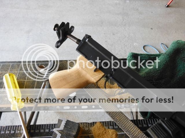

Anyway, got around to fitting the pistol grip today. I managed to trim the inside of the pistol grip so that it would accept the factory grip screw. With a little bit of drilling and routing with a dremel I had it fitted in no time. Next thing I had to do was shave off about 1/8" on each side of the upper part of the grip so that it would be flush with the sides of the receiver and so that the safety lever could operated. This was easily accomplished with a rasp.
The pistol grip locks up nice and tight even without the ferrule there for the factory grip. I removed it but left the trigger guard intact when I did my initial Dragunov conversion. The Yugo/Tabuk grip is very comfortable! The swell and size of it is leaps and bounds better than the factory one.

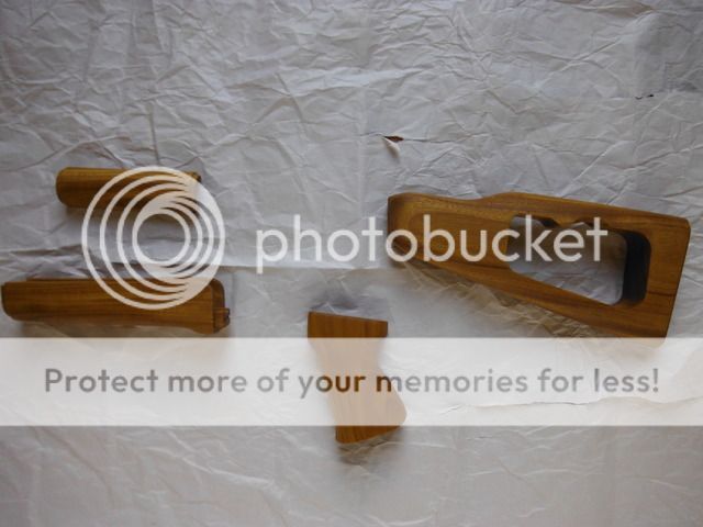

Nice day outside so I took advantage of the lighting and snapped a few pictures of the wood with the first coat of tung oil on it.
I'll be buffing it again with the steel wool tonight before I put on a second coat.

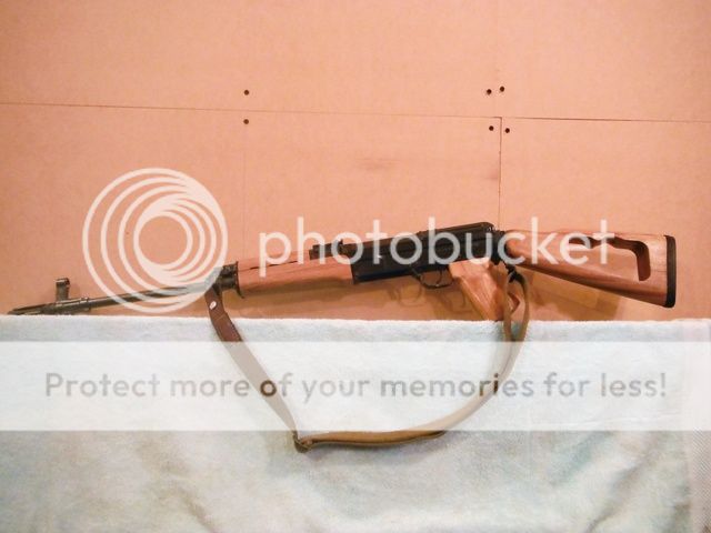

Today I applied the last coat of polyurethane clear coat to seal the wood and protect the beautiful job the tung oil did. Once the pieces were completely dry I couldn't wait anymore to finally fit them on to my CZ 858. I absolutely love how well the wood dresses up the rifle. I managed to put it all together so you guys can see what she looks like all done up. I"ll be bringing her into my gunsmith this week to get the side rail put on and have the stock screw cut down to size so I can properly tighten the stock in place. Once I get her back I'll post the final result pictures so you can all enjoy.
I'm not sure how those pictures relate to your project...but whatever.
Yeah, I'm not really sure but cool rifle nonetheless. I envy the states when it comes to some things.

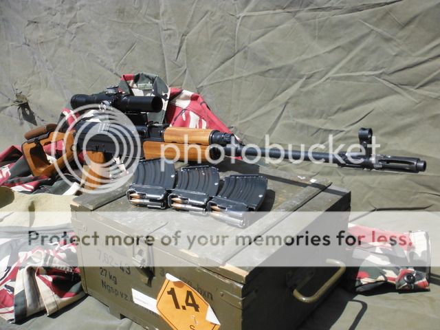

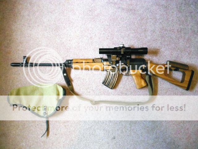

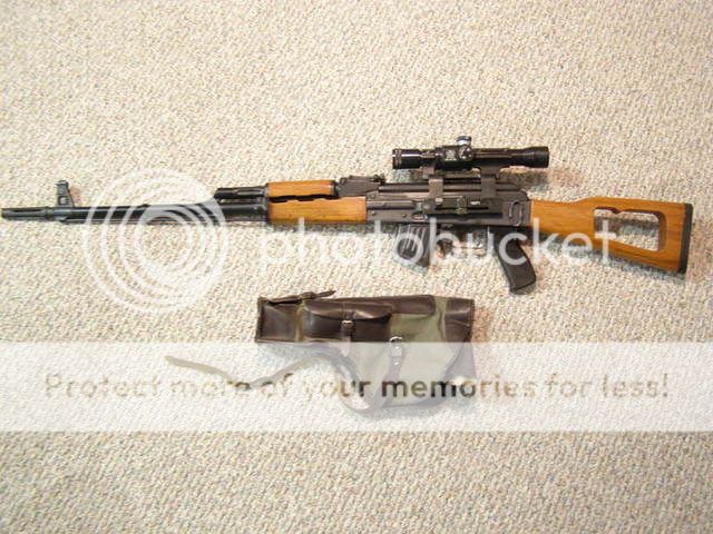

So, I'll let you guys be the judge. The top picture is that of a genuine M70 Tabuk and below it is a picture I took of my CZ-858 Tabuk.

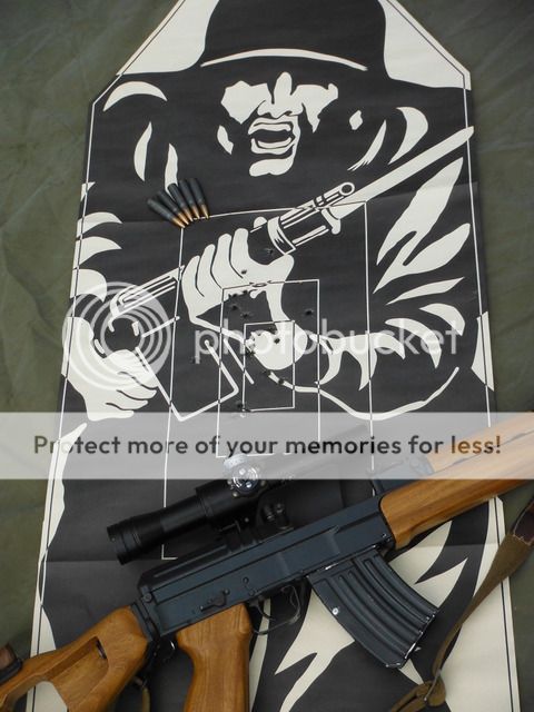

By the time I had her all good to go I put 20 shots into a Fig. 11 target. The group is nothing crazy but, considering I was shooting Czech surplus ammo and that the barrel was good and hot by the time I shot that group, I am happy with it.

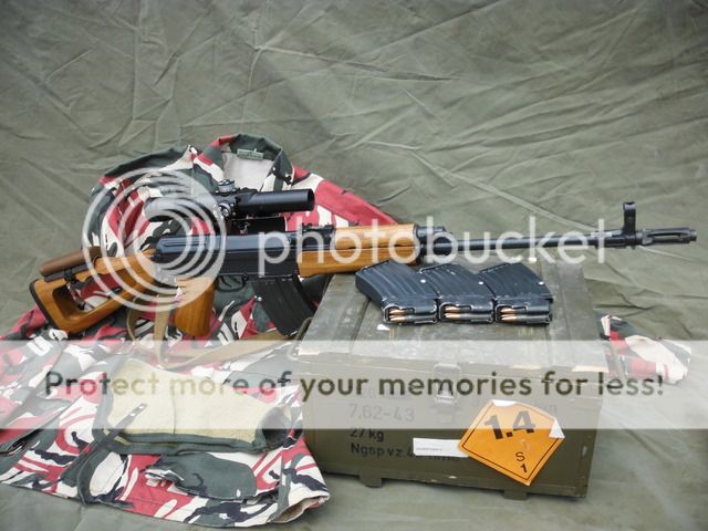

And now... For your viewing pleasure, here are a couple pictures I snapped to capture the beauty of this rifle.
