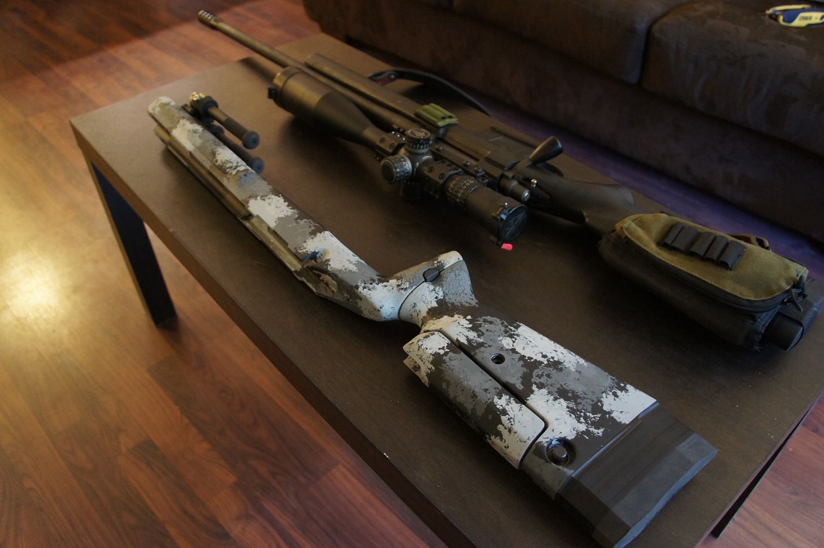

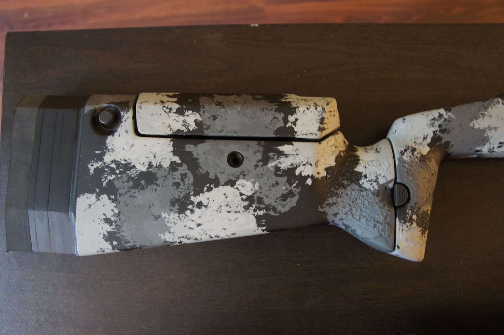

Stock is here guys! She is a real beauty! It feels amazing, build quality matching and exceeding McMillan quality. Fit and finish is perfect, and the stock locks up as solidly in the open position as a fixed stock. Simply amazing!
Sending off the barrel off to tac-ord to do the barreled action, then to corlanes to inlet the bottom metal into the reciever, then finally back to tac-ord for finishing.

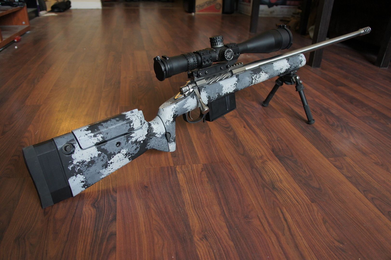

Just a few more photos and a video.

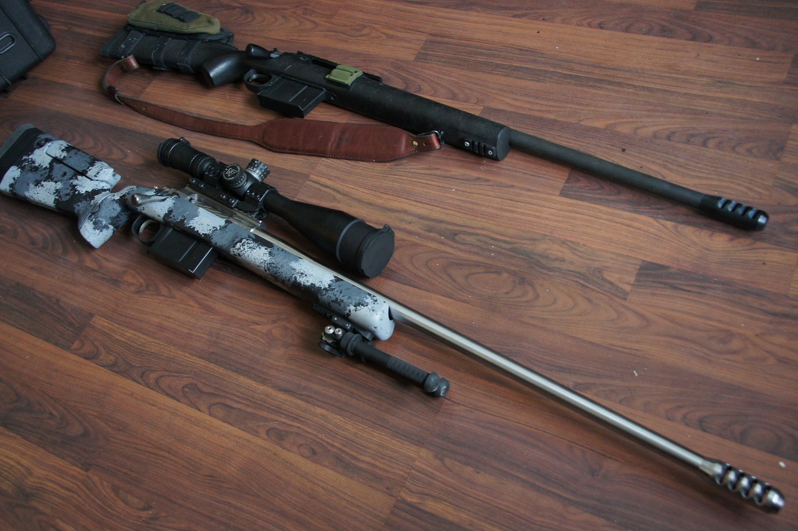

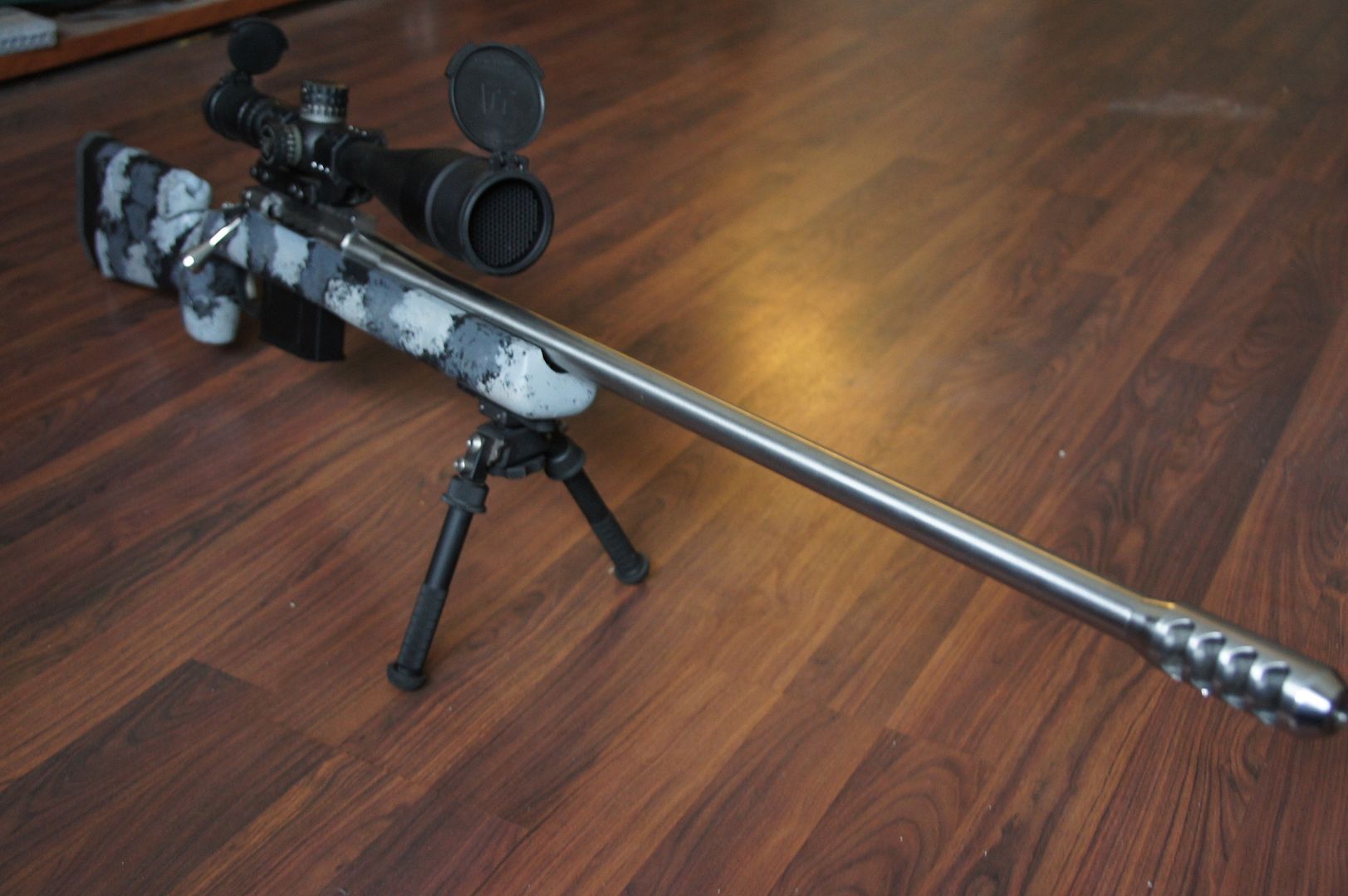

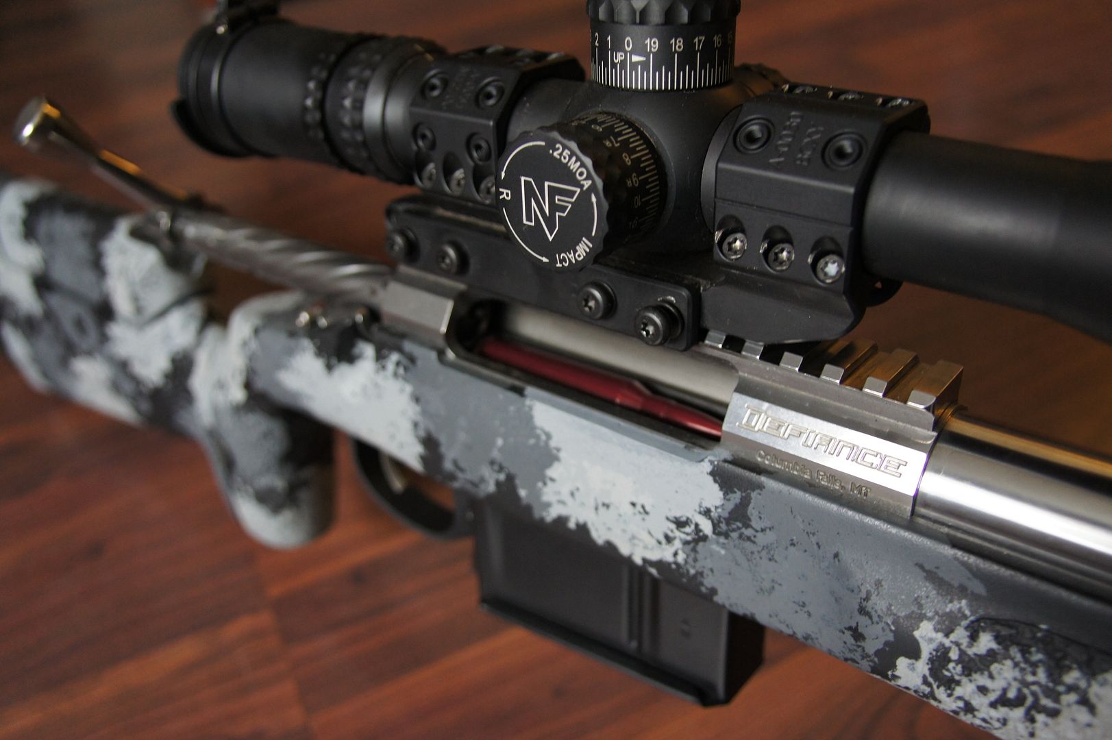

It's been a tremendously long time in the build process. In fact it has been exactly 6 days under the 2 year mark.

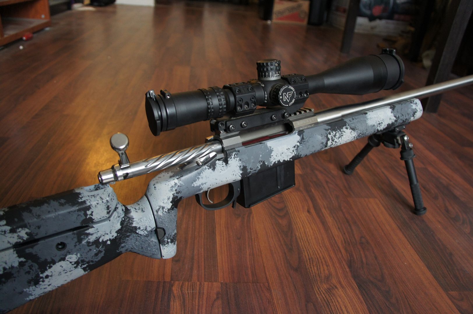

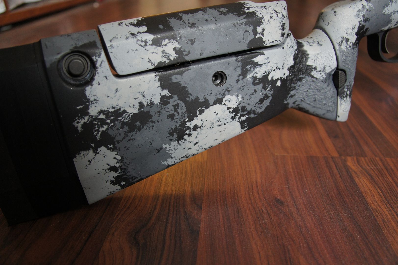

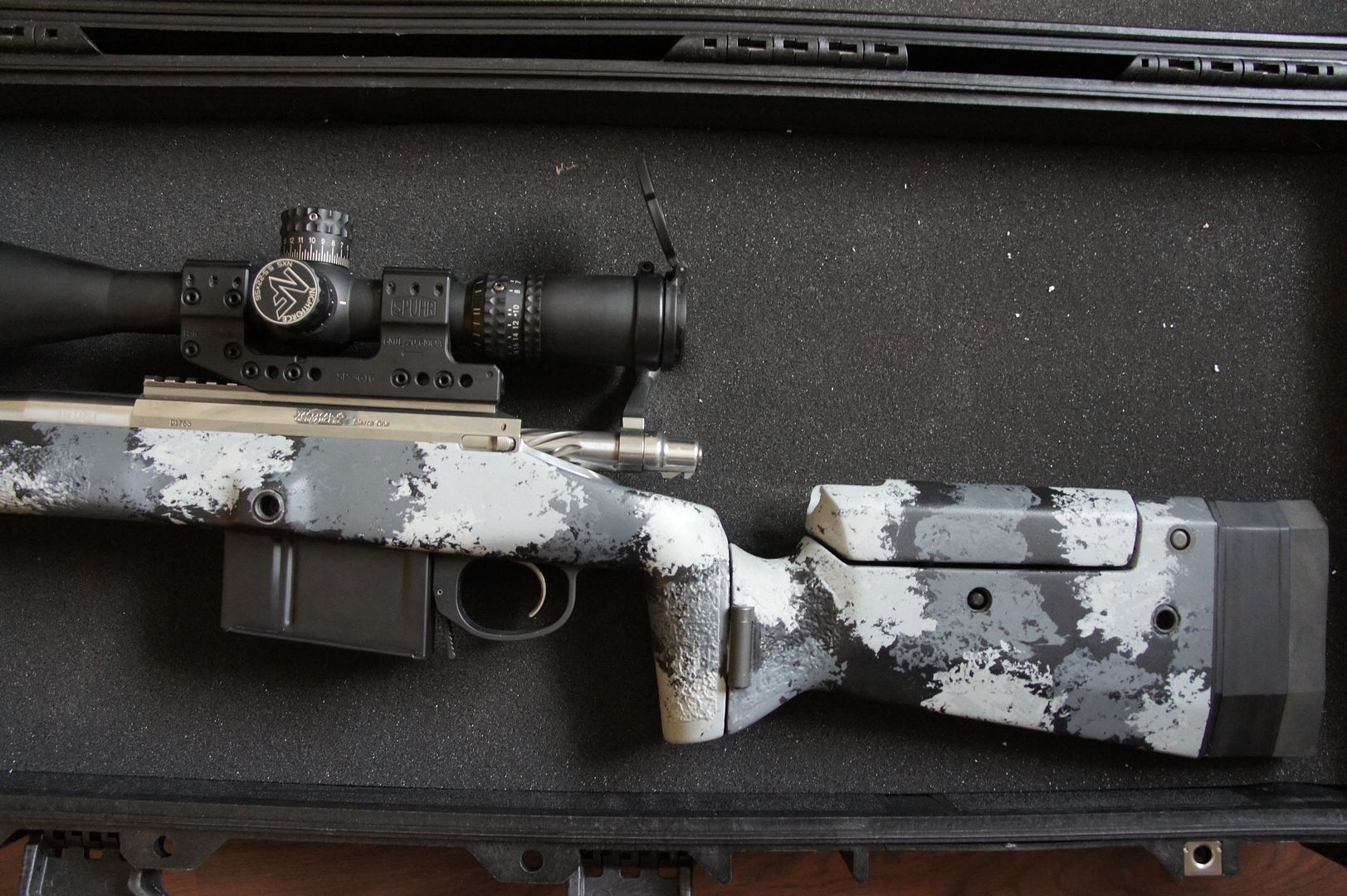

Still have to play with the scope mount position and length of pull, as length of pull is too long right now, gotta remove some spacers and then adjust cheek riser position before locking the scope down.

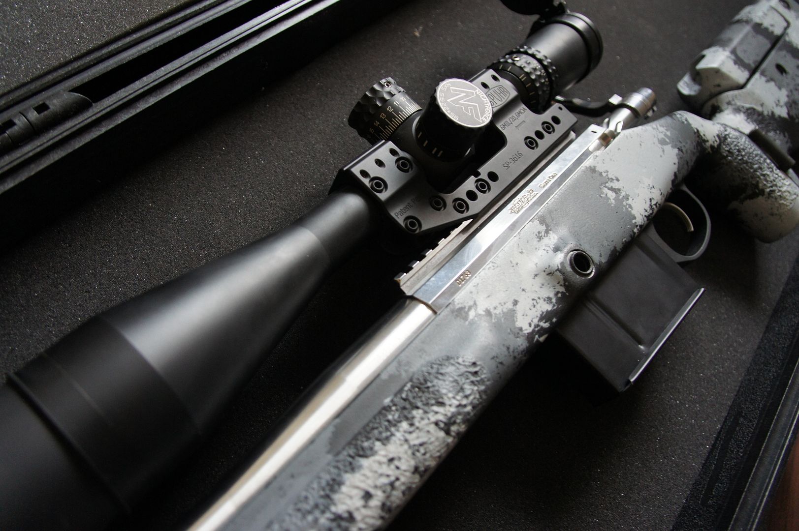

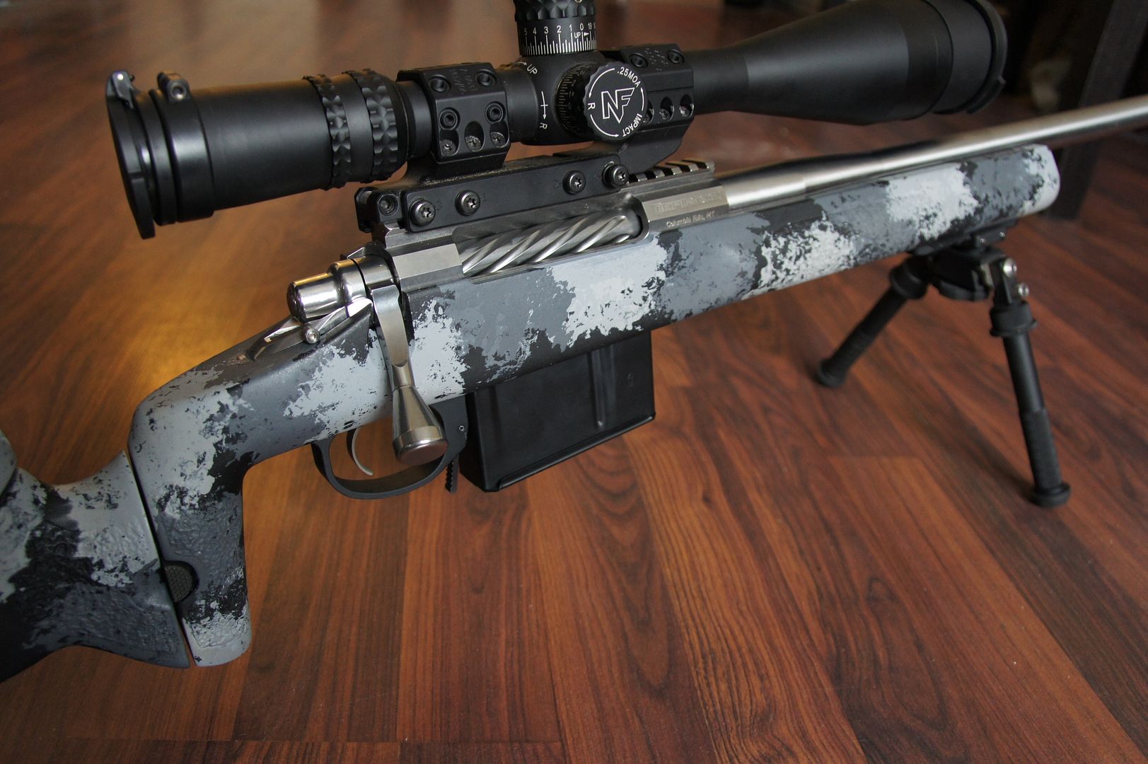

Action is bedded and buttery smooth when feeding snap caps, trigger tech is just as good as can be expected, trigger snaps like a glass rod.

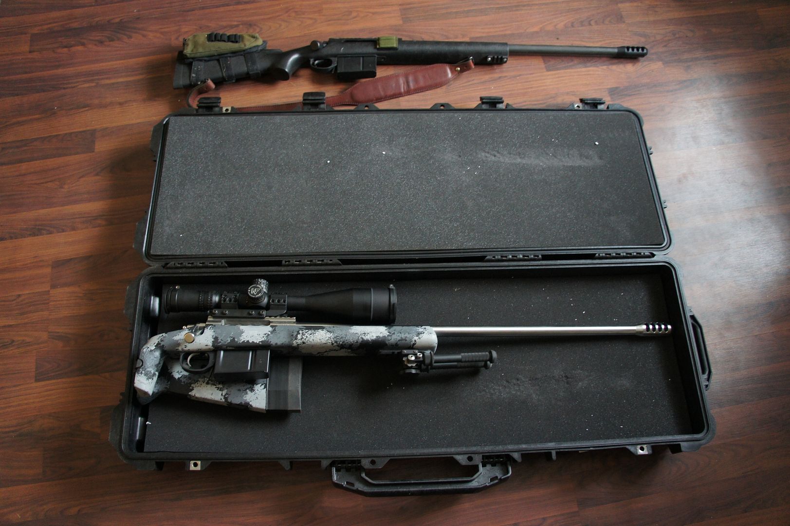

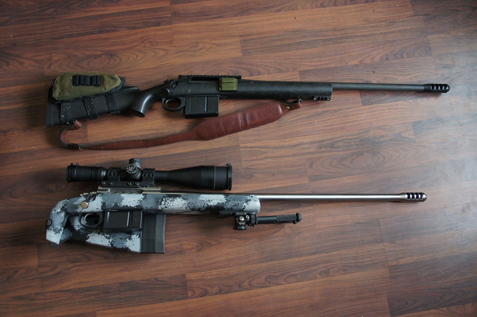

Best of all is the barrel is several inches longer than my Remington 700, but due to the folding stock, the whole package is several inches shorter. I can fit it into the short pelican cases normally reserved for more compact rifles. Gotta do some custom foam work when I get the time.
The double stack magazines were an awesome choice, as the extra height gained by having shorter and wider magazines makes prone magazine changes far smoother, and I no longer have to contort the mag to get it in without moving the rifle off target.
Now I just have to spend a bit of time with all my stocked up chinchaga projectiles and start making some test loads to see what makes this baby purr.

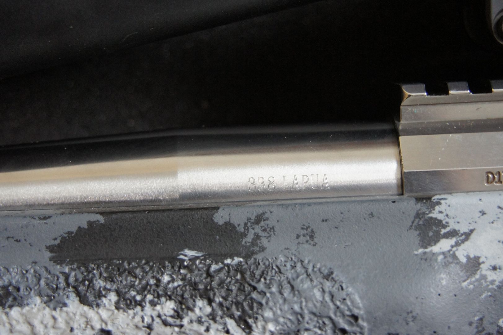

The stainless and black go awsome with the stock colour. What brake is that, a Terminator?
I love the Spuhr mount and wish I would have went with 1.
I really love the colours in it. I don't know if I will end up coating the metal or not, I'll sit on it a while before I make that call. The brake is a custom machined APA Fat Bastard, a real solid brake for this cal. The Spuhr has been my go to for about 4 or 5 years now on all my big bores, there are other great brands, but the spuhr has the build quality and adaptability to do what I want, plus it is just a ###y piece of machine work.
