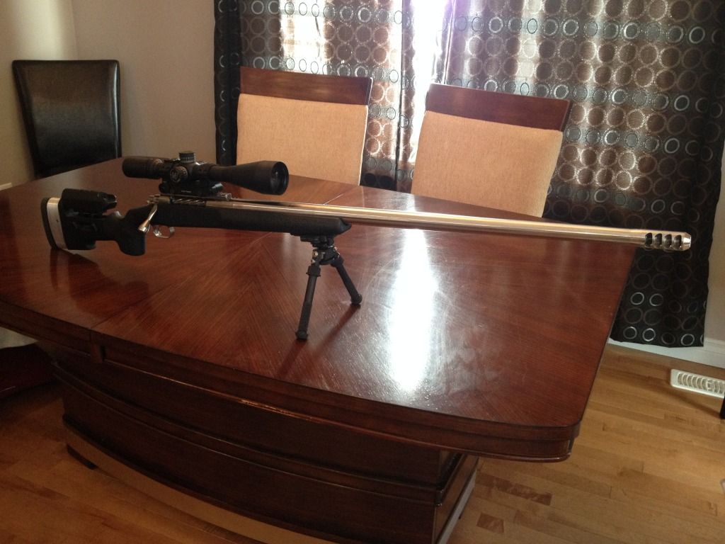

Defiance Sierra One .338LM complete! Photos on post 111.

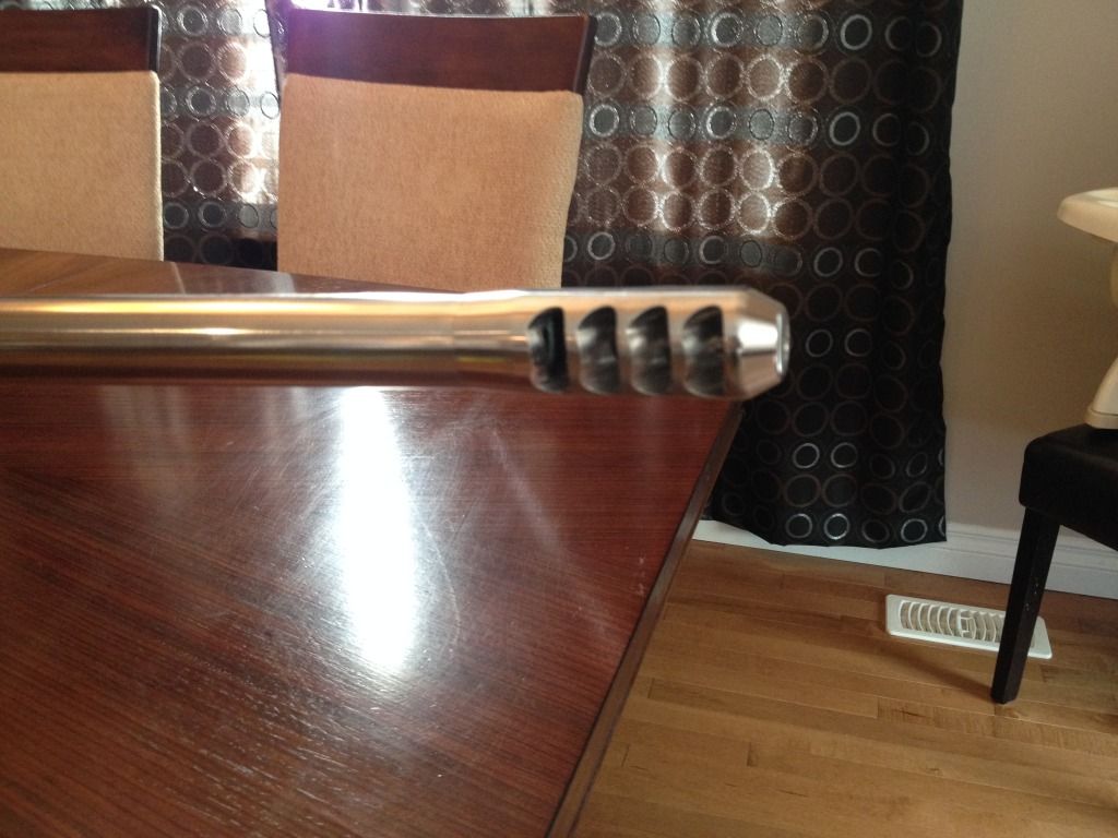

That barrel is so skinny!! What diameter does it finish up at?

It's a heavier profile than it looks like. Measures .830 at the end of the barrel, as per Whitley Palma contour, just double checked it with the dial calipers as well.
ABCDEFWght
18Whitley Med. Palma1.2503.0005.500.95030".8305.65#
gotcha. Mine starts at 1.350 and has a 8" shank length befor going straight taper to .900 at the muzzle at 32" finished. The barrel started as a 1.40 and my smith had to turn it down.

I'm pretty happy with the contour I chose, I think it is a very good middle ground between stiffness and weight.
