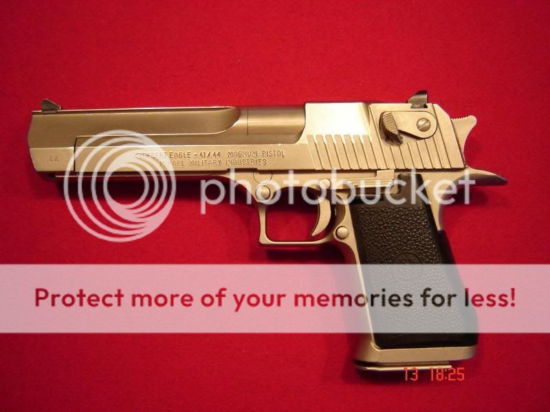

Well, here she is. Squeaky clean and ready for more boom booms :p
Question. Is this gun nickeled or stainless? My $$ are on nickeled, but I wanna be sure ;)
