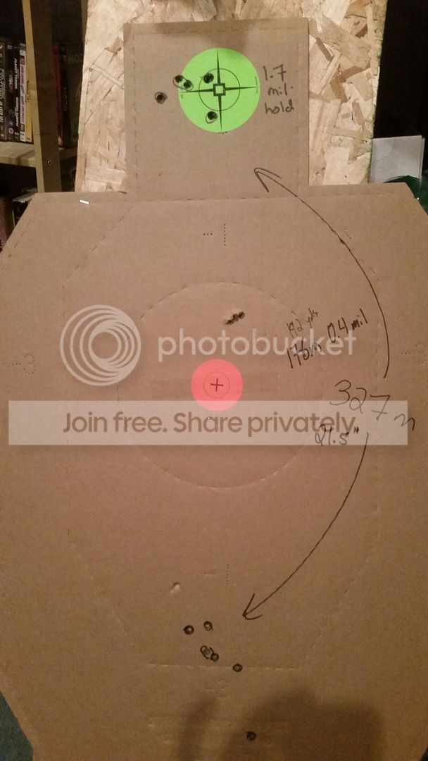

I have been trying to determine a more precise velocity for my handloads. I find the exact definition of muzzle velocity to be somewhat subjective.
When I chronoed my load (178 AMAX over 43.5 grains Varget at 2.840 in a Federal case) I set up the chronograph ($100 ProChrono) about fifteen to twenty feet from the muzzle. I averaged 2647 fps over eight rounds with the biggest difference 16 fps.
To try to get a more accurate velocity (and to practice in case my chronograph ever gets taken hostage) I set my chronograph up at exactly 100 meters and got an ever age velocity there. When I put the numbers into my Strelok ballistic program the velocity at the muzzle was a but higher.
Finally I shot at 327 meters and got a 21.5" drop and used that to true the data and it figured I had a 2733 fps muzzle velocity. That seems fast compared to other data I have seen for similar loads from a 24" barrel but maybe they measured differently.
