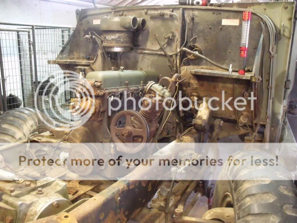

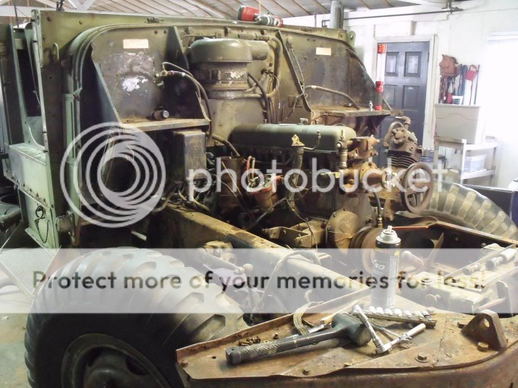

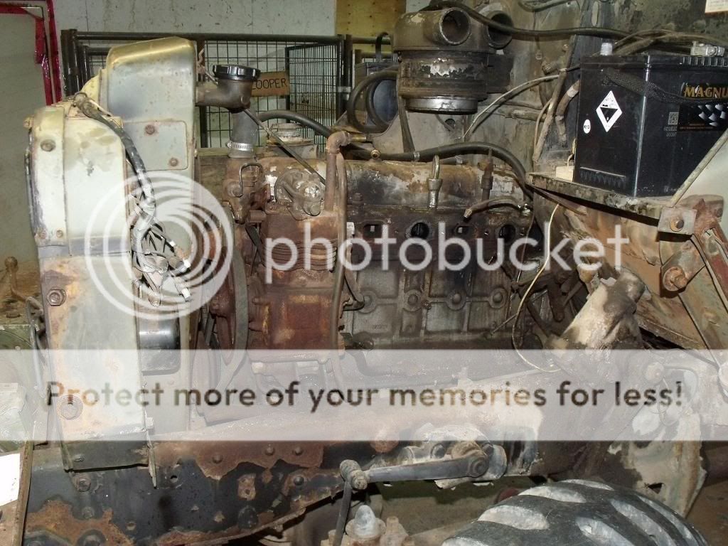

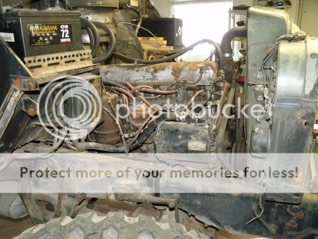

The heating bill is killing me vut Ive been plugging along on the mechanicals...
But DAMM there was a lot wrong with this truck.

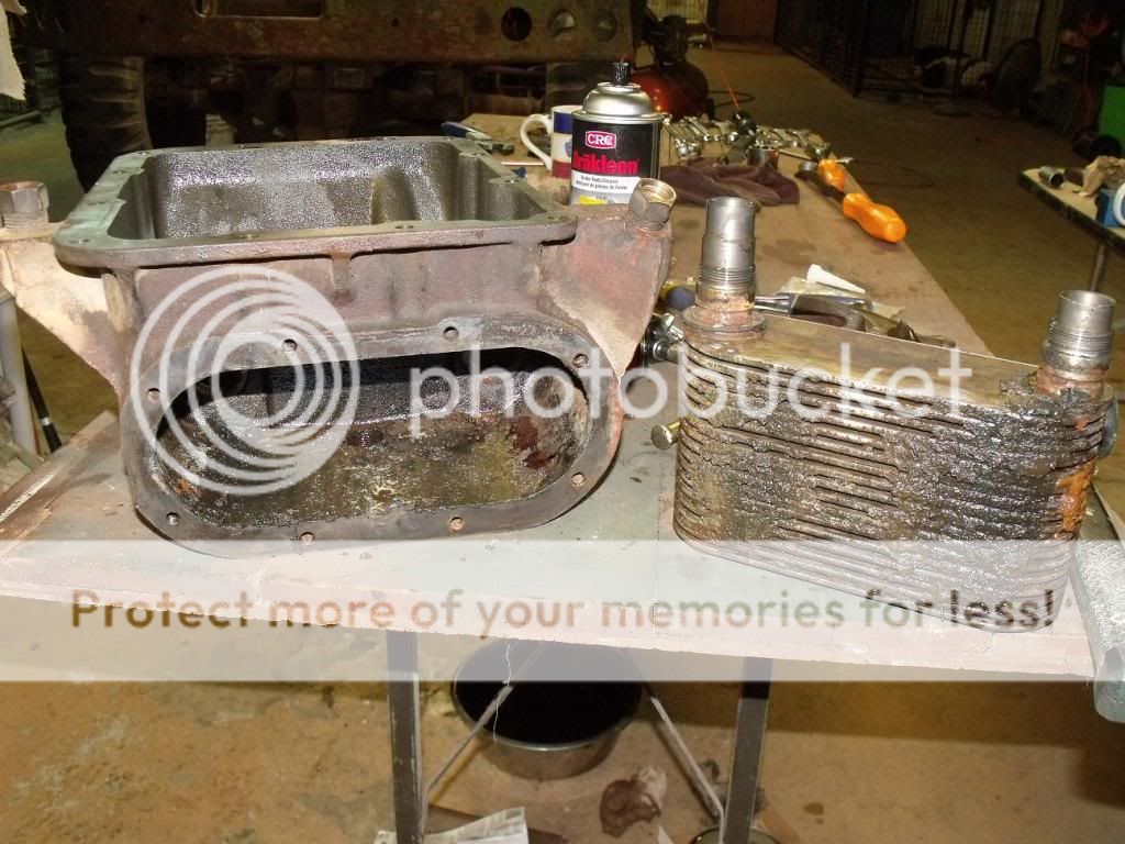

The cooling system was almost totally plugged with rust and scale and dead mice...as was the tranny (engine coolant is plumbed too the tranny...the whole system was completely clogged-which explains why the engine acted as if it was overheating the couple times I started it ....duhh)

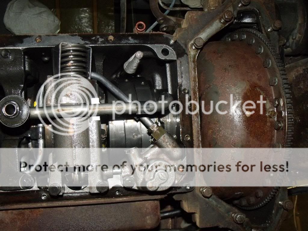

And some doofus had disconnected and pinched off the oil line to the top end of the engine...!!!...no oil to rockers or valves...
anyway...heres some pics...
and some of the tranny...
tranny cooler on bench (note goop...that was after multiple cleanings before I got fed up and removed the whole dam thang)

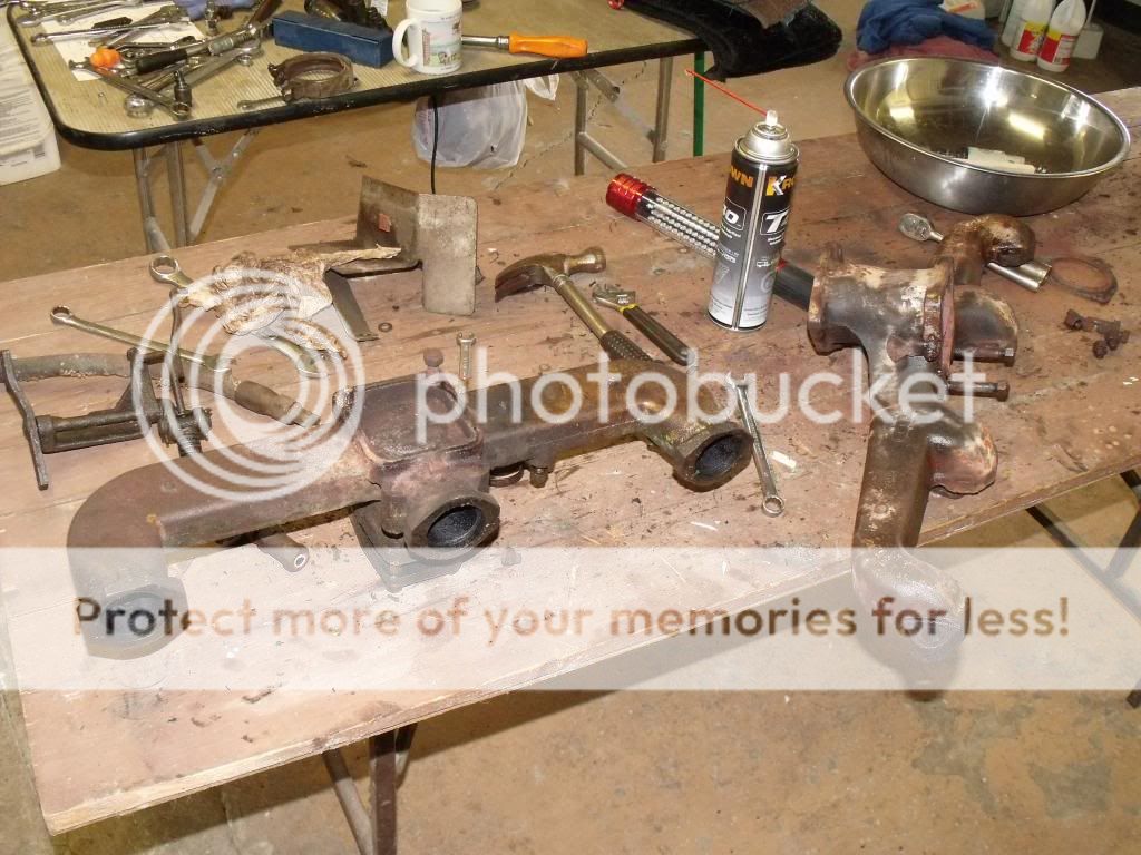

Is the exhaust manifold cracked? That was one of the jobs I remember doing again and again and again on these trucks, along with wheel cylinders. Oh, and wheel seals, and diffs, and transmissions, and valves.
Of course the manifold was cracked...I had it partially welded and partially brazed-should last for....about....I think I just heard it crack again...
