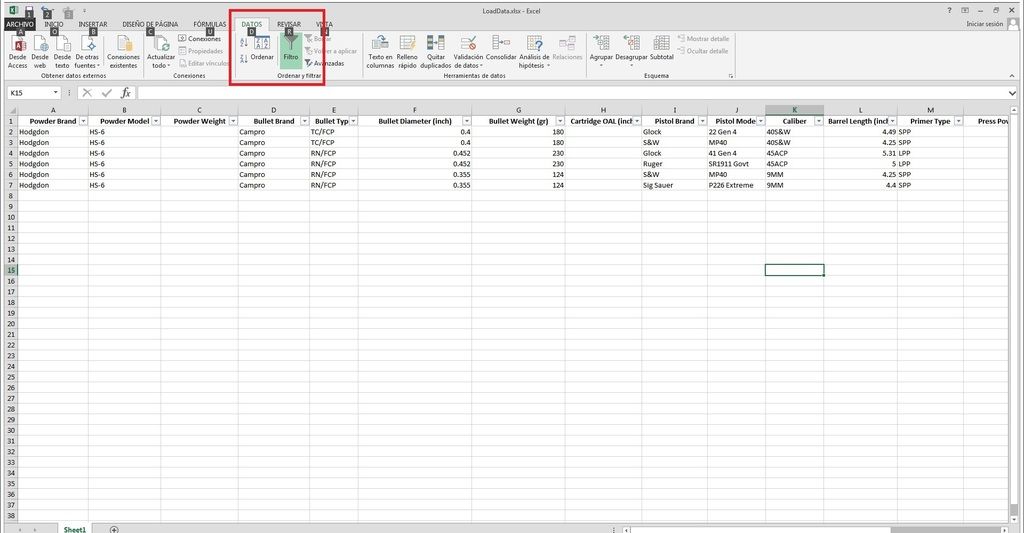

I couldn't find a way to attach the file here. so the screen shot. it's a spreadsheet based on Granderite's logbook, added my own fields and filters so that you can easily sort and filter out the information you need to check, for example, only 9mm, or only 5 inch barrel length, or certain bullet etc. If anyone wants the file, please pm me with email and I can send it to you. it's very easy to create your own though. the "sort" and "filter" are on the "data" menu in excel. sorry about the spanish. it's for work.

luckey, I have almost the exact same thing except I use a new tab per calibre and add fps, and a notes column. I even have a tab that I imported the entire Hodgdon 12 ga Shotgun loading data with a few macros, I think it is 28,000 entries just because I didn't like that you can't search (filter) on their website based on all types of component, ex where is a 12S0 wad used with titewad.
Hi Seagull, yes, the screen can't capture everything. the note column is at the very right side, along with other things like my own caliper measure on the powder meter etc.. I didn't use the multi-tab approach as the filter is just a dropdown. if I want to see 9mm only, it's just a mouse-click away. beauty of the computer, always multiple ways for the same thing. :)
for the macros, glad to see we have more techies who also play guns. :) , since the purpose of this is a "lab book" for personal best loads, depending on your purpose of this spreadsheet, probably it's not required for everyone.
