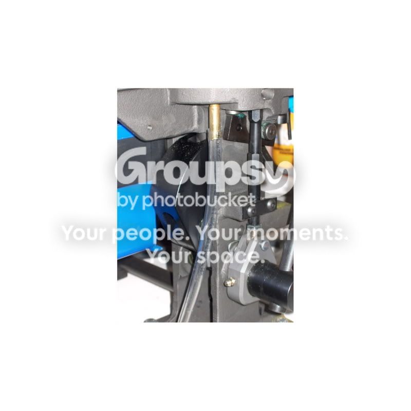

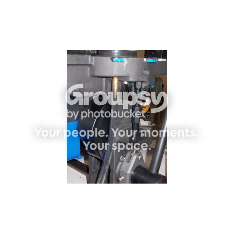

I was reading an FAQ on Brian Enos forum and saw something that caught my eye, so I tried it and surprise, surprise it works.
The 1050 spent primer catcher sucks the BIG one. I had removed it and used a funnel and a piece of clear hose to ferry the primers away. It left a little to be desired but worked.
This mod involves cutting the case head from a .223 case (i used a Remington), placing an appropriate size and length of clear tubing on the cut end, and jamming the case neck into the ejection hole on the press.
