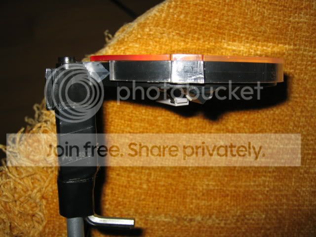

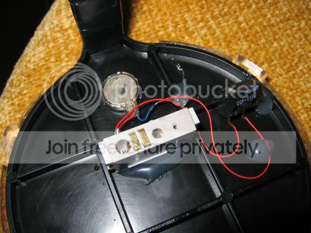

I was too late to get a Franklin Arsenal unit, and too cheap to splurge $$ on a RF100, so I made a loader out of a Lee AutoPrime, primer loading tubes that came with my LnL, and a vibrating motor from a dead cellphone:
Works like a charm. ;)
aridan.... brilliant!
Right down to the three dabs of hot-melt glue, power jack and switch.... brilliant!!
