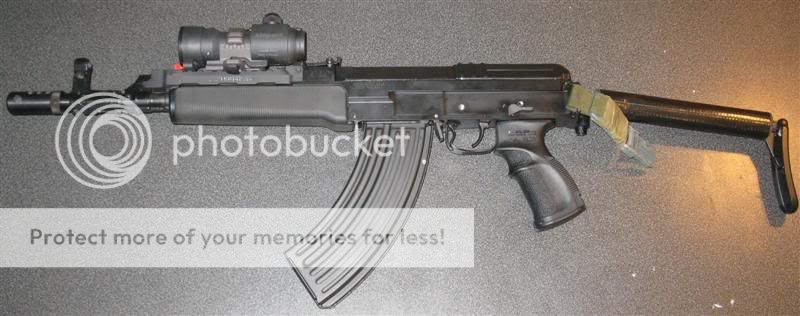

now , i like my restricted VZ58s be fitted with folders and its no secret the standard VZ folder is one of the most uncomfortable one to use. stevo thread had me revisiting the idea on how to make my new FSN-01 more comfy with a folder.
i dont know if my idea will fly, maybe members with woodwork experince will let me know.
heres my idea , the standard red compressed stock is too thick so i would split it in half , removed 7/16" along the center, screw the two even half on either side of the standard folder . ofcos it will require minor filing to fit .

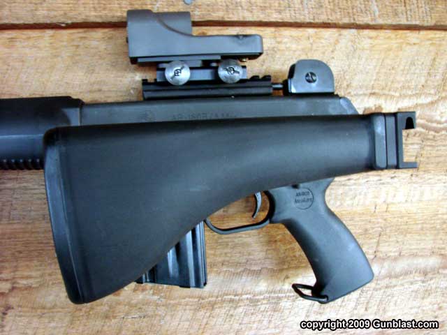

cant fold the red stock cos its too thick so it needs to be thinned.
duct tape and foam is fine for a black rifle but i wanna keep this red and since i never seen a red stock folder before , i thought this might be good idea , just like the ar180b folder.

I had similar plans, except it involved using cherry wood blanks routed to accept the folder arm and then fitted to mate with the buttplate. The two halves would be glued together and glued to the folder arm, then fitted to allow it to fold properly, (hadn;t worked that out fully yet). Wood would be stained to match the rest of the 'wood'.
I only have gotten as far as rough cutting the blanks, and making a new pg for it though. Post the results if you do it.

You will need a band saw and to make 1 of the 2 cut's required.
First to cut off the amount needed to ruduce to allow the folder to work properly on the smaller side of the stock that attaches to the rear of the reciever.
Then another cut down the middle. I did this with a table saw and removed the 1/2 inch from the top of the stock.
I then grabbed 2 screws and bolt's and did the same type of idea as a kydex check riser. This took up the amount needed to properly close the stock. Then to keep it from moving back and forth I simpley cut 2 strip's in the back of the stock just enough to use some belt straps to lock it in place.

You know that fabric MOLLE atachment's device's like so;
The 1's from Maxpedition called TacTie Straps worked the best and can be found from seals action gear.
Now cut slot's up and down the rear of the metal butt plate on the would and feed them threw. Or you can simply drill and tap the top part of the stock to hold it on to the folder.
