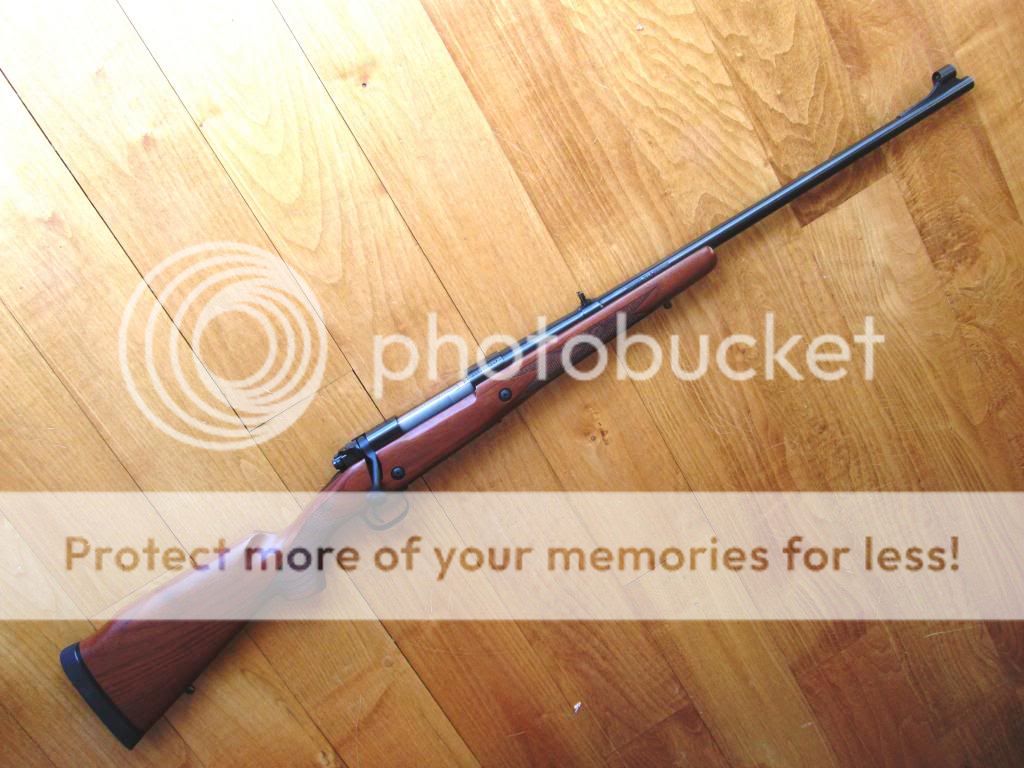

OK, so after starting this thread I went ahead and bought the .375 H&H that I had my eye on. I'm just waiting for some pieces to show up so I can load up some ammo and try her out.
I have some older Model 70 rifles, but I've got to say...this new one is really nicely made...great fit and finish and one of the nicest factory triggers I've ever felt. According to my scale the rifle weighs just under 8 lbs.
Here she is...the Winchester Model 70 Alaskan .375 H&H...looks like a KING to me!
I have some older Model 70s, but I've got to say...this new one is really nicely made...great fit and finish and one of the nicest factory triggers I've ever felt. According to my scale the rifle weighs just under 8 lbs.
Here she is...the Winchester Model 70 Alaskan 375 H&H...looks like a KING to me!
Very nice. Looking forward to range reports.
BongoBob that is very nice, smooth, clean lines.
There is something special about a Mod. 70 Winchester, sort of timeless in style.
Mine is coming back in a couple weeks ( not a 375 ) but I'm anxious to shoot it again, very anxious...
Thanks for sharing the pictures and we look forward to updates from you...
