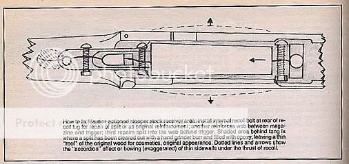

Here's a picture from the Jack Lott article.

Thanks Mauser 98 that makes some sense to me. Jack Lott makes sense to me. He was a shooter and gun guy through and through. I just could not understand how a single piece of rod bedded in behind the recoil lug could help anymore than a good bedding job. However a internal bolt bedded outside the width of the recoil lug and full length of the barrel channel acts as one unit. Makes sense to me. Now I can sleep.
