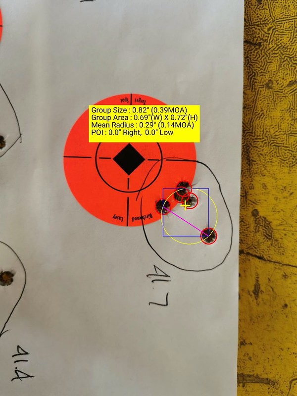

Had a chance to try out the D4350SSC Powder today.
IbI stainless 26 inch MTU barrel,
6MM Creedmoor Starline brass,
CCI #200 large rifle primers,
Sierra HPBT 107gr,
41.7gr
Loaded to Ogive length of 2.2150
1-2930
2-2936
3-2918
4-2890
5-2900
Avg: 2914.8 FPS
SE: 19.52
ES: 46
First groupings at 200 yards
And the best load numbers I got but not the best groupings...
40.5gr
1-2805
2-2796
3-2809
4-2788
5-2804
Avg: 2800 fps
SD:8.38
ES: 21
41.7gr
1-2930
2-2936
3-2918
4-2890
5-2900
Avg: 2914.8 FPS
SE: 19.52
ES: 46
40.5gr
1-2805
2-2796
3-2809
4-2788
5-2804
Avg: 2800 fps
SD:8.38
ES: 21
Nice
What bullet? 105’s?
