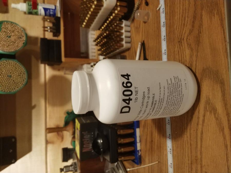

I picked up a 5er of D8208 in the white jug. Label on it is so faint i can barely make out anything. Like it sat in the store front full sun for years lol.
Got a jug of each D8208 and D4350 last friday and both are like that. I'm thinking the same thing or printer's really low on ink.

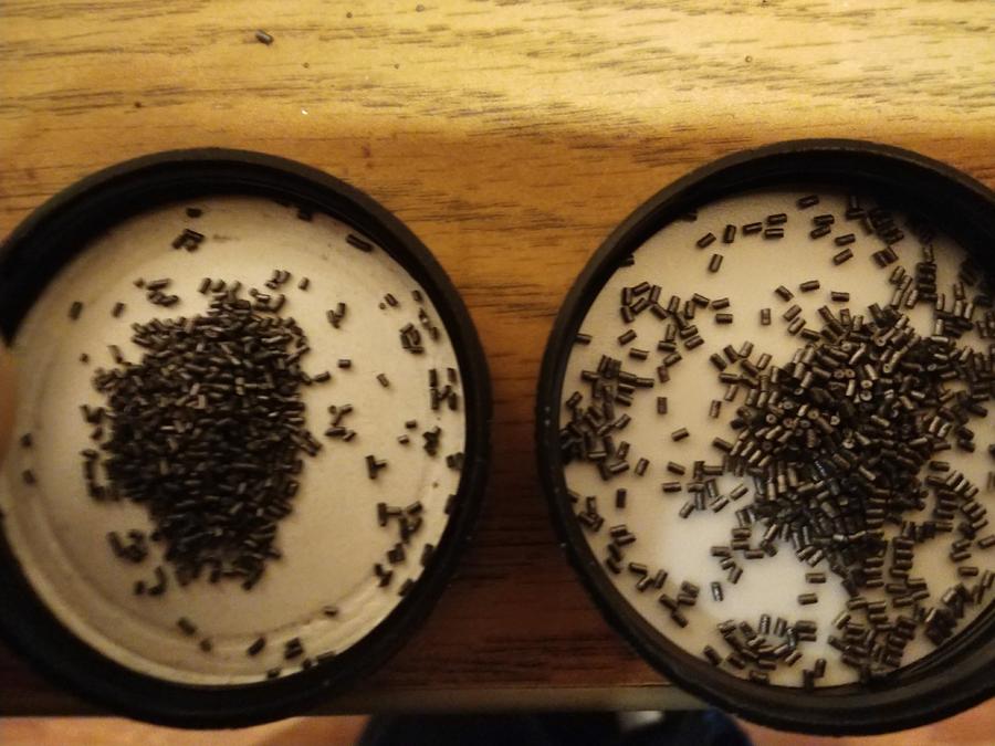

The SSC powders are unfortunately not shorter cut or thinner cut than IMR or H or Accurate. The SSC designation is not even shown on the 1lb. bottles anymore, at least on 4064.
When I compared the two I thought the SSC was quite a bit shorter. That's only with my own 4064 but yeah...
Here they are IMR on the left Dominion on the right IMG_20210413_110528.jpg My hot triple deuce load overfills the case!
