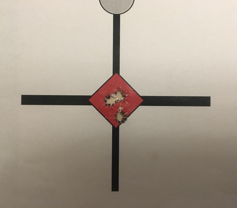

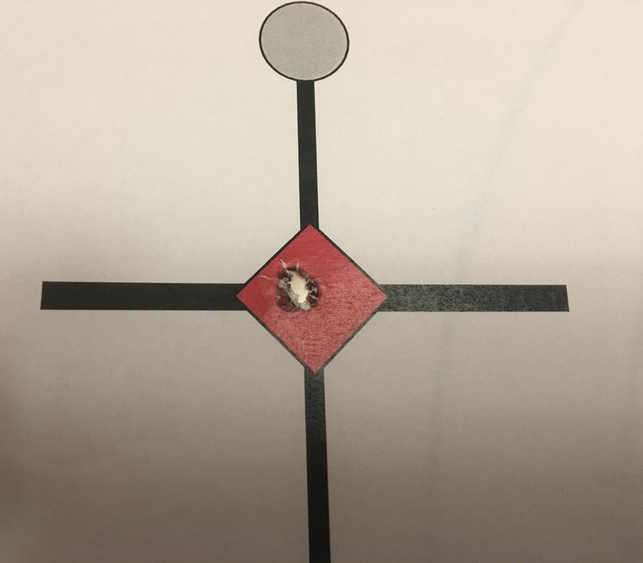

Ran some ladders on the weekend with D4350 in my 6.5x55 Tikka Varmint. Really impressed with this stuff! Most groups were 0.5-1” with a couple notable exceptions. Spreads were the best I’ve ever produced, single digits sometimes.
I hope this stuff isn’t too temp sensitive...
I was really happy with this 0.317” group, spread 9, St dev 4.9, 3 shots, 100m
Then this happened next. 0.059” group, spread 12, St dev 8.5, 3 shots, 100m
My new Zastava 6.5 x 55 is not shooting quite that good, but ground hog season is here, and I have yet to bed the action. Regardless, under an inch with 95g V-Max with 47 gr. of D4350. It is more bulky than H4395, but shoots more consistently. No easier to meter.
