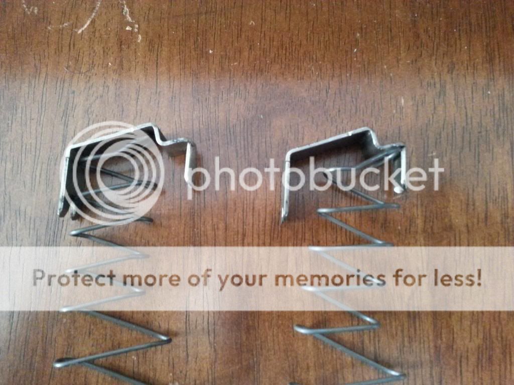

I have this exact issue with ACT and WOLFF (rebranded ACTs with WOLFF springs) 8 rd mags; the most common culprit is the smaller upper portion of the magazine spring not riding / staying inside the raised portion of the follower. If the top of the spring rides forward, the spring folds on itseld and makes loading an 8th round almost impossible and usually results in failure to chamber from slide lock and / or failure to extract / eject after firing first round. When the spring rides against the rear of the mag body, these run at their best spring wise. This is an intermittent issue that I haven't found a fix for other than reassembling my mags while watching for the spring to seat in the rearmost hollow of the follower before topping them off. Hope this helps...
Edit to Add:
The one on the left is how the spring should seat inside an assembled magazine; the one on the right will not let you top off with 8 rds and cause 1911 unhappiness as mentioned above......
