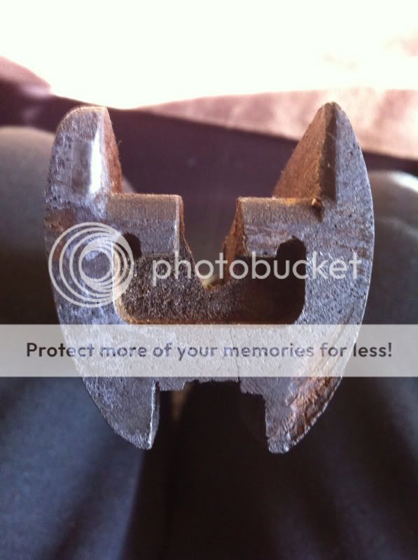

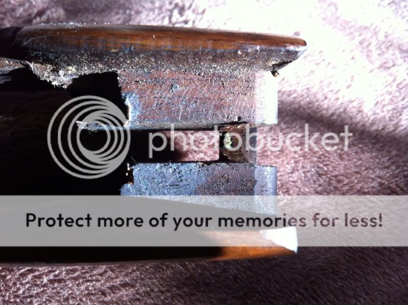

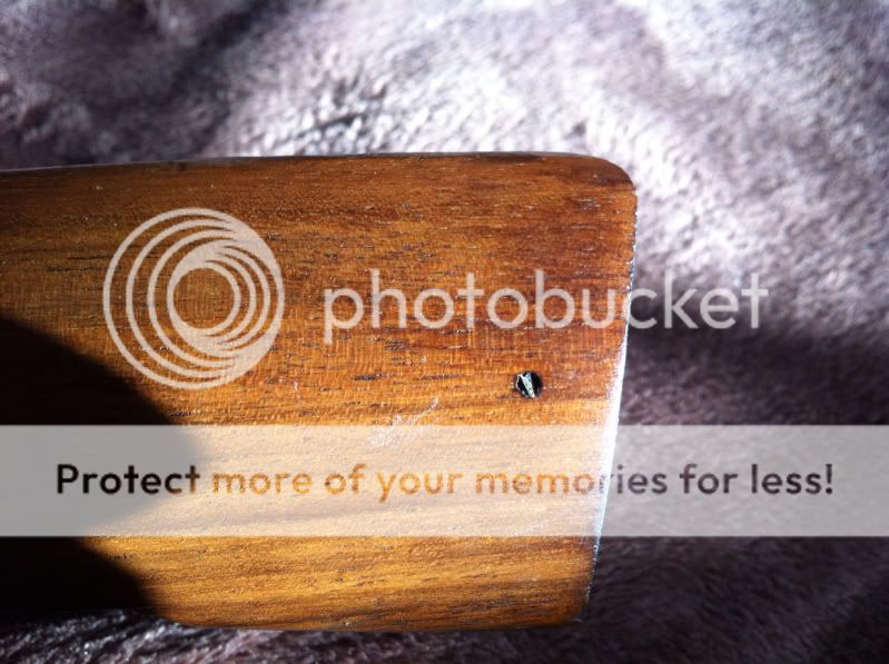

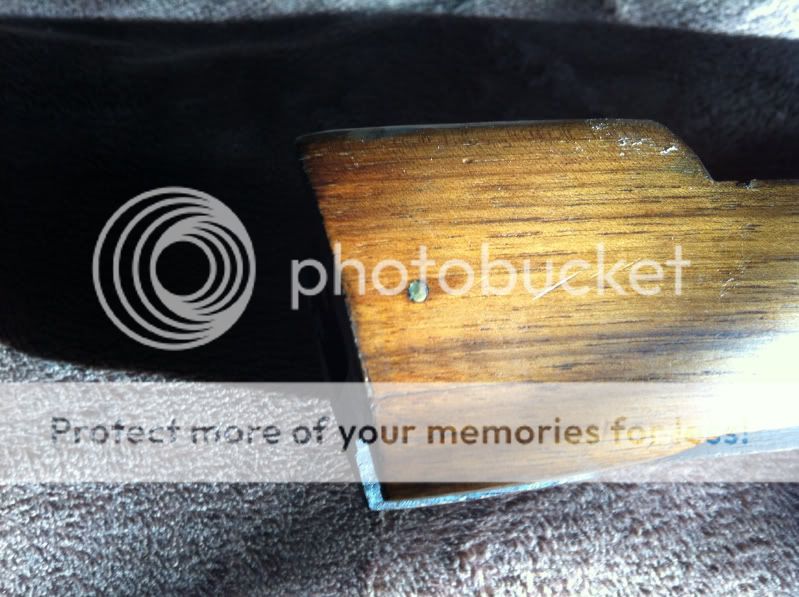

Smellie is this what you are talking about. This gun had never been apart since I have had it nor do I believe the guy before me did. I remember the the two small holes one on each side of the stock when I got it but had no idea what they were. The screw is holding everything tight and the crack doesn't appear to open when I twist the wood.

Yes, that is The Damned Crack and the screw IS holding the wood together, but it appears as if you have a lot of wood missing from critical parts of the Forestock.
I have one here which is very similar, on a rather nice full-length Forestock. So far, it has taken 4 sessions with the Acra-Glas and it still is not built-up enough to assemble to a rifle. It CAN become a long job.
If you have a stock with a decent set of Draws and no Damned Crack, you can get an Acra-Glas GEL kit and start rebuilding this one. Then you will have a spare, you will KNOW how to do the job..... and you are on your way to being the neighbourhood "go-to guy" on .303s! Another possibility is that you could end up being the neighbourhood depository for .303 junk.... which is not at ALL a bad position to be in!

Yep, that is "the damned crack." As SMELLIE states, (and I agree), one of your best bets is to take LOUTHEPOU up on his offer of a used sporterized forestock.

[/QUOTE]2) In the S&K instructions, it tells you that you have to relieve a bit of wood from down in the forend where the screw goes across the front band. A dremel tool would work best. Just enough.
Let me know how it goes, please.[/QUOTE]
That did it...I picked up a dremel tool on Kijjijji and took my time, its on and the bolt clears :) ....now to sight her in....thanks all .
