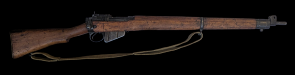

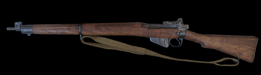

Here is the newest milsurp addition - a 1942 Fazakerley No4 Mk1.
This is without a doubt the roughest Lee Enfield rifle I have ever seen fit/finish wise. The finish is mostly a silver/ grey colour. The metal finishing is similar to the many wartime Mosins I have had over the years. A very nice, salty wartime rifle. A few small LB marked parts as well. Two groove barrel.

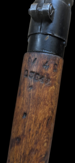

Do you guys have any thoughts on the stock of this rifle? It's a lighter colour than typically seen walnut. I did read that during the war the British used Beech and Birch with less than great results. Does this look to possibly be a beech or birch wood stock? I don't think it's been refinished and the stock serial numbers look ok? Did the British serialize the foreends in 1942?
that stock is not walnut - it's beech. The gun isn't an obvious refurb, so it may be one of the fairly uncommon Faz guns to have been beech stocked during the war. Most No.4's got walnut or Birch until the post-war era.
Obviously, it's darkened from decades of oxidized linseed oil.
Serializing forestocks was done during the war but not overly consistently. A lot of stock were not serialized at all. For example, Maltby didn't serialize fore-ends, and Faz and BSA sometimes did, but not uniformly.
Guns that got FR or FTR were often serialized if the forestocks were going to removed during service. It's basically impossible to know if a forestock was serialized at the factory or at a depot today though. The forestocks are typically stamped in a larger font that the receivers or bolts, so comparing die strikes and character shapes isn't that informative.
The 9/42 stamp is interesting - I've not seen a factory 42 faz with a dated forestock, but it could be an inspection or FR date. Possibly the stock was serialized in Sept 42 when that mark was applied - where that happened is anyone's guess. It does not look recent or faked to me and the serif fonts look period.

If it's FR marked, the 9/42 date is likely a field repair date and likely the serial number was also applied then. The rifle was likely made earlier in 1942. LB and Savage shipped a lot of spare parts with their rifle shipments to the UK, and some of those parts (most commonly magazines) ended up being put in newly produced british rifles, while other small pieces like safeties sometimes were used to repair british rifles at field depots, despite not being complete FTR refurbs. There was a war on, and all that.
I was hoping for a month on the barrel but no such luck! I wonder when in 1942 it was made? Is this likely the original barrel then? Was the “FR” more of a “first line” repair vs a full on “third line” FTR? Sure makes you wonder where this rifle ended up over its service life.

That action has a lot of the No.5 lightening cuts as on receiver and bolt. Both variants were Faz production.
My No.5 is a 1945 Faz build and it’s just as rough looking as your No.4.
I’d say that parts commonality between them as well as production process was the same to streamline the build so they could keep the guns flowing to those that needed them.
FR means “field repaired” which generally means a unit armorer did work on it. Could be as simple as changing a flip sight to the mk3 sight, changing a handguard, or something like that.
The barrel looks to be original and probably is.
I suspect the welds at the ends of the charger bridge were part of the FR.
It’s possible though in 42 the work was rough right out of the factory. I would not be surprised if it were original. In my experience, early war Faz guns were the roughest of the lot on non-critical surfaces.
I also notice at some point an A suffix was added over the end of the serial number, and if it had been factory, Faz usually stamped the serial numbers to leave room for the A at the end of the serial, if it was needed. I rather suspect the A was added at the sept 1942 FR to denote a non- standard part was fitted somewhere on the gun. Likely something that had to be hand fitted.
