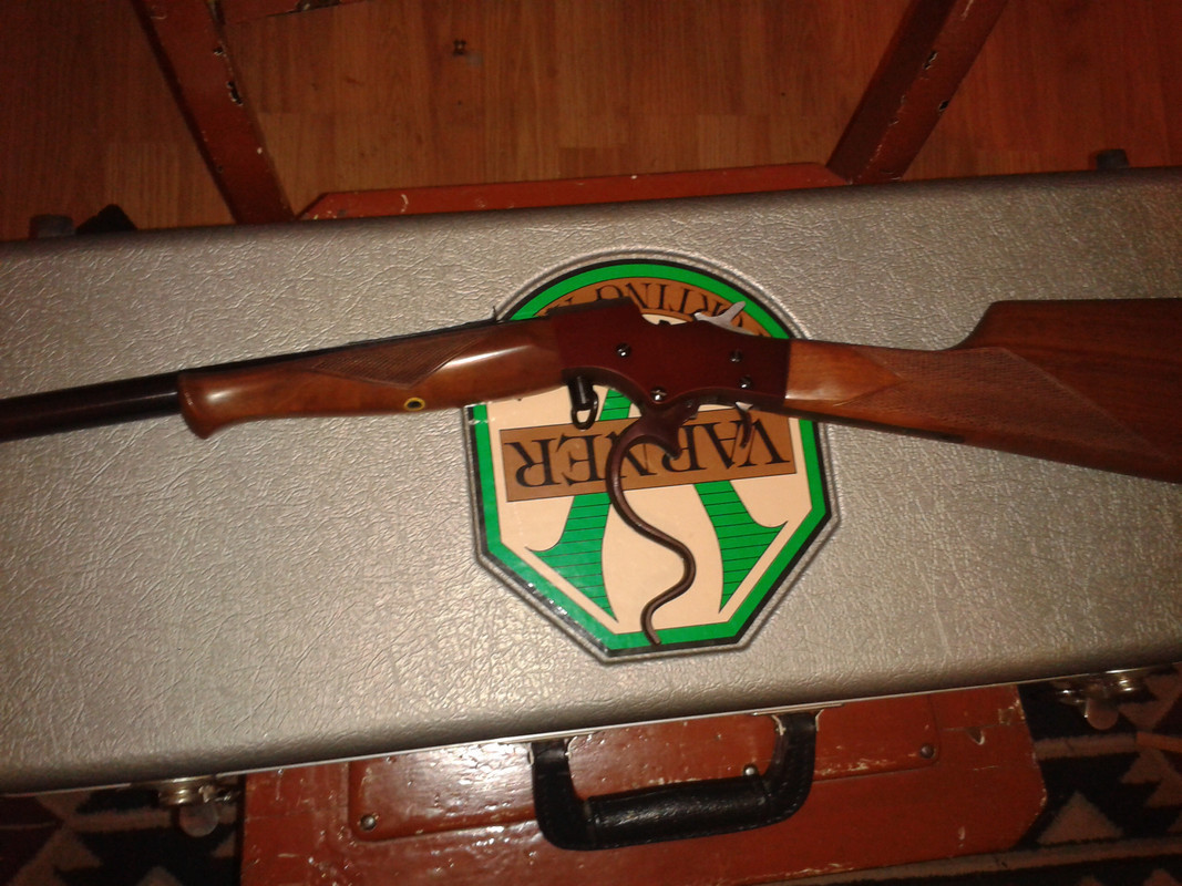

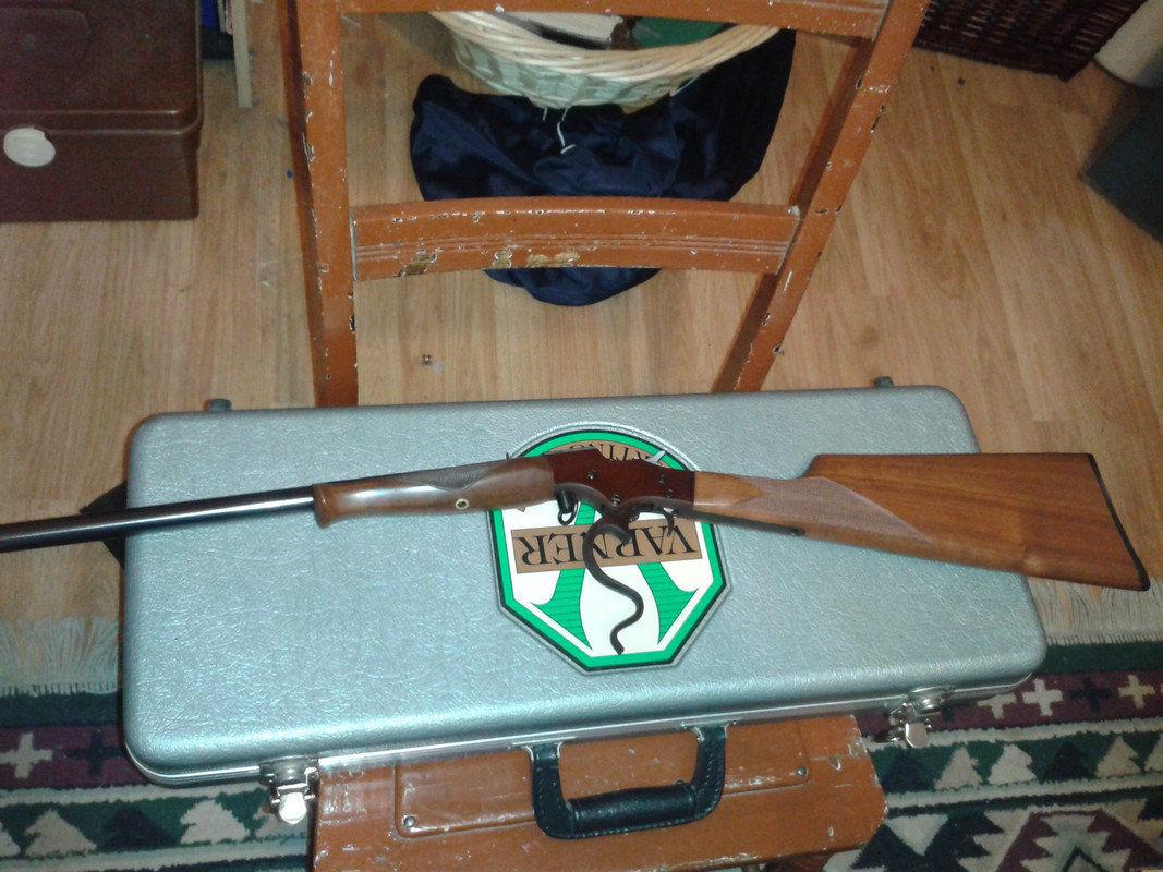

I have always been a fan of the stevens favorite and years ago I had one of the early Savage remakes of the favorite and now I have one othe Varner Stevens replicas
Fun little guns. Can't remember why I parted with the one I used to have...
Got 44 that I am going to eventually rebarrel to 32-20 or 32 S&W. 32-40 is making me a little nervous.
Dream of having the disposable income to call up CPA and get something really nice on a new Stevens action but that's not in the near future. Might have to look out for another Favorite in the meanwhile.
