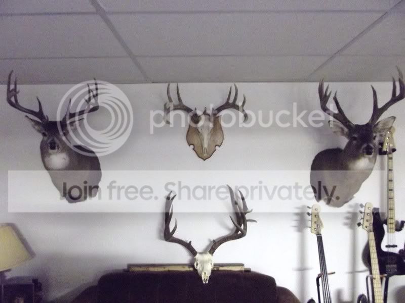

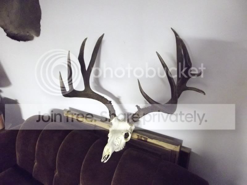

Here are a couple of mine. Very easy to do and turned out great! Took them to my taxidermist :)

Did you get yours munted on a wood base, wall mount? I got mine cleaned in Meadow Lake for $75 but want to mount it to the wall.

beautiful trophy wall by the way sksavenger

Hunting in AB with my Daughter & Son In Law, my Daughter did a European mount for me on my first AB Mulie. All the Deer back there look like monsters compared to what we have here on the island. It was a decent size, had a little 'junk' on the head gear but it was a special Deer for me in that it was my 1st hunt with my Daughter, my 1st AB Mulie and I got it with my recently deceased Fathers 30-06 Husqvarna light weight.
She went through a lot of work on it and did a good job but I'm not sure on the method or procedure she used. I'm happy with the results though:D.
