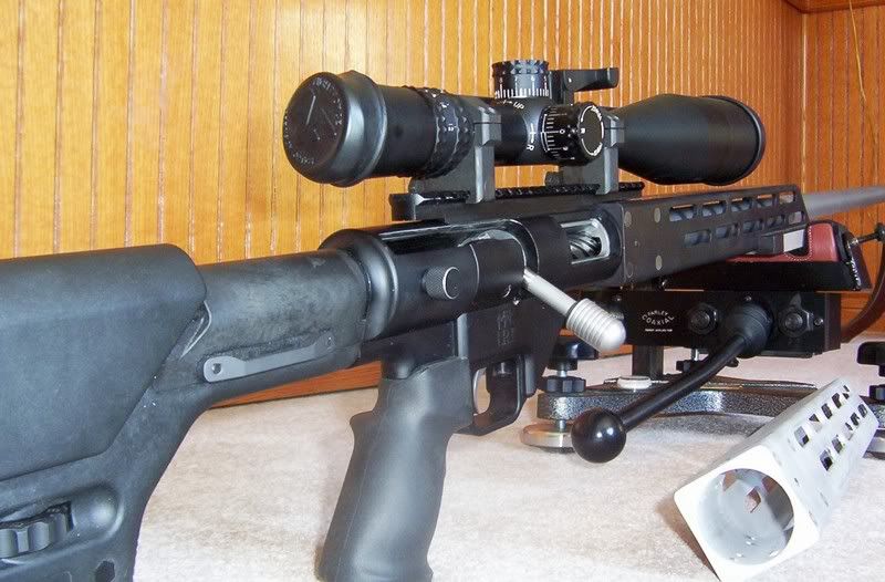

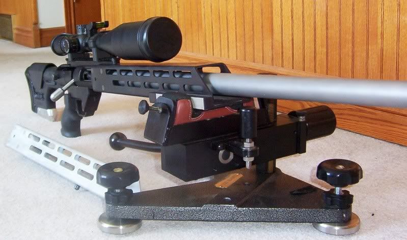

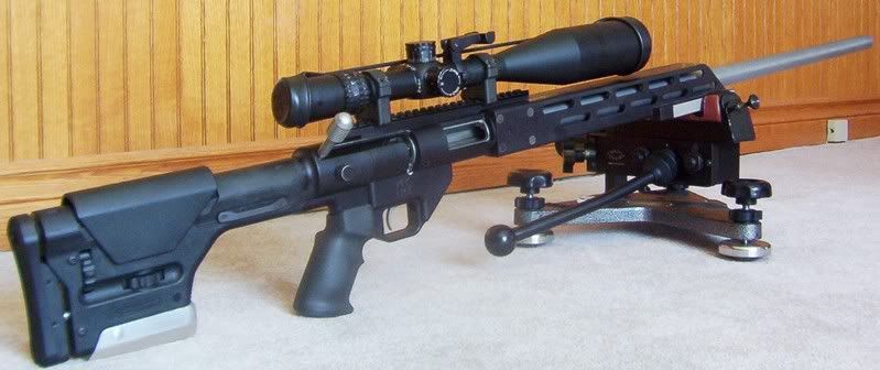

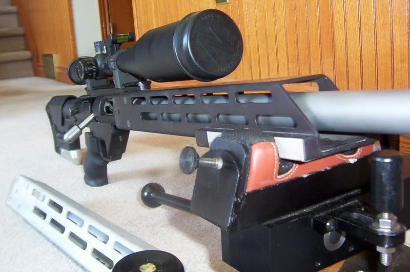

A few people have inquired about Tube Guns again so I thought I'd post some details of the F Class version (bag rider).The original kit has been modded some but
the concept is to have an action that can be switched out to suit different needs.The Kit is designed for the Remington 700 action.
This one was built off a PGW M15 action with dual bolts (308 and WSM boltfaces) and is set up for easy switch barrel and calibers.There are now 4 different forends and 3 different butstocks that are swapped out to meet needs.The scope rail is 25 moa buit in.
This set up as shown carries a Broughton 30" 1n8 straight taper in 260AI.
The forend has been set up with a 3"wide bag rider and the butstock is a Magpul with custom bottom rail to ride a 3 stitch bag.Inside the Magpul and inline with the bore is an 11 oz mercury recoil compensator balancing the rifle to center and negating recoil impulse.(It tracks straight and you can watch your hits)
It's scoped with a Nightforce NXS 12-42 to help see that 5" Vbull.
This has been designed for quick stock removal to make it fit in travel case.

Nice rifle. Hope she shoots as well as she looks.

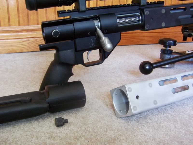

How is the forend attached it looks like it has 4 hex bolts clamping the forend to the receiver block, have you had a chance to shoot it and does the forend flex from the recoil
Do you have to put the rifle further over the bags to eliminate any upward pressure.
Trevor, It shoots very well,match proven. NO flex at ALL .Lower COG than most BR stocks.Better shooter than present skill level..
Tracks straight back in recoil as it's balanced and has 11oz merc recoil comp directly behind bore so recoil impulse is straight and low.
Other Tube, first build ,was on a Rem 700 with round forend tube to shoot off a pod.Pics of it are on Kevin's site.It was shot at Provincials off pod in 05.
3rd build is under way and will be even less traditional and fully experimental.
Because of a good solid center core (sleeved action and pistol grip) all sorts of variables can be added to stock design as they are easily swapped out without messing with central action.One fellow even turned his build into a "hunting handgun" (US ).
I think they are worth consideration for a precision rifle build.
I can attest to the accuracy of gords gun ,when he was fireforming even at 100 he was making one slightly large hole.And at 300 it wasn`t much larger.
Terry please tell the specs on that!!!
Barrel and length? what is it shooting and what is it shooting like?and why is the bolt on the wrong side?:D
Jamie
Just for you Jamie,
6.5x284 setback barrel Broughton 28" 5C, 1n8 twist. Remington 700 action, Magpul PRS stock, forgot the grip name/model...it's ambidextrous, 4.5x14 Leupold tactical Vari-XIII model, MAK tube of course.
139 grain Silver Scenars at approx 2940 fps, H4831 powder, 20 thou off the lands, 5 shot group 4.5" at 785 yards (lasered)...first load tried. Velocity was extrapolated using the come-up required to center the group from a 100 yard zero.
Lefthandedness is a gift, not everyone gets it.:D
