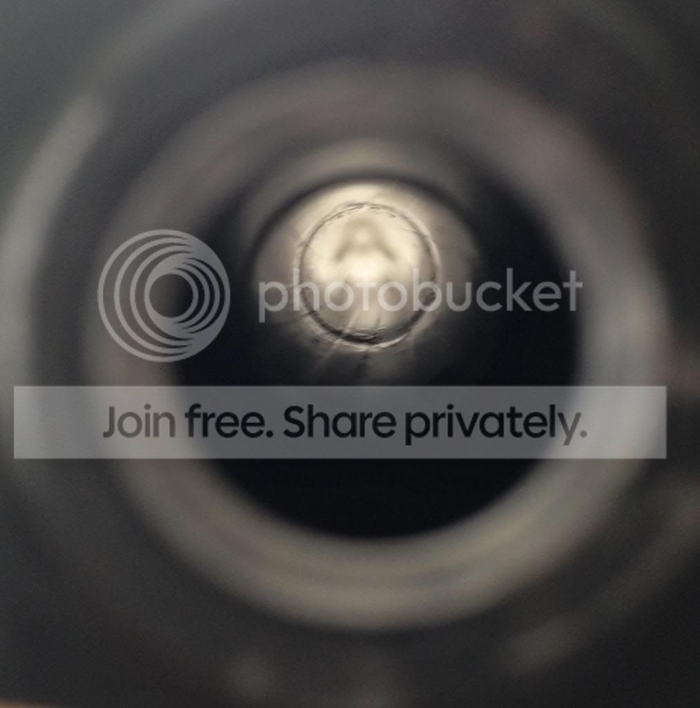

This is what rings look like:
For further confirmation, rub some oil on the outside of the barrel to make it shiny. The look up into a light and scan down the outside of the barrel. At this point, you should see the bulge if there's any. Also, pass a dry snug patch through the barrel slowly and feel for any change in resistance.

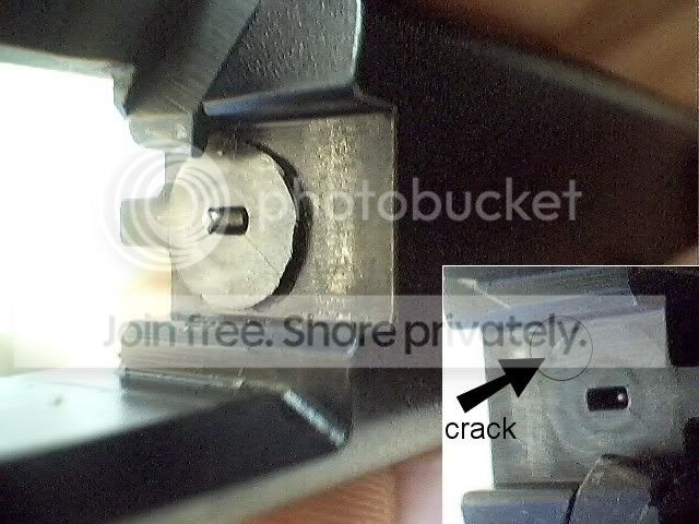

This is what a Glock striker hole looks like:

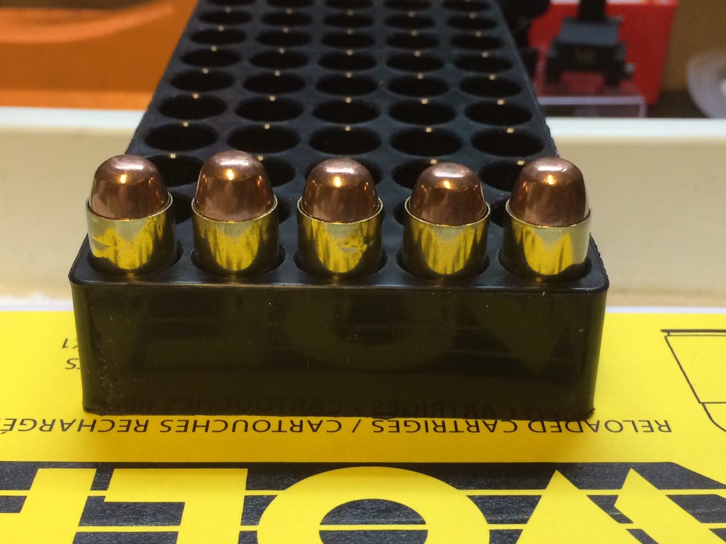

Here's a pic of 5rnds of 45ACP that the bullet got pushed into the case. You could actually push the bullets in by hand...
We had a box of Wartak 9mm that was the same. The bullets were not crimped well enough and you could push them into the case by hand.

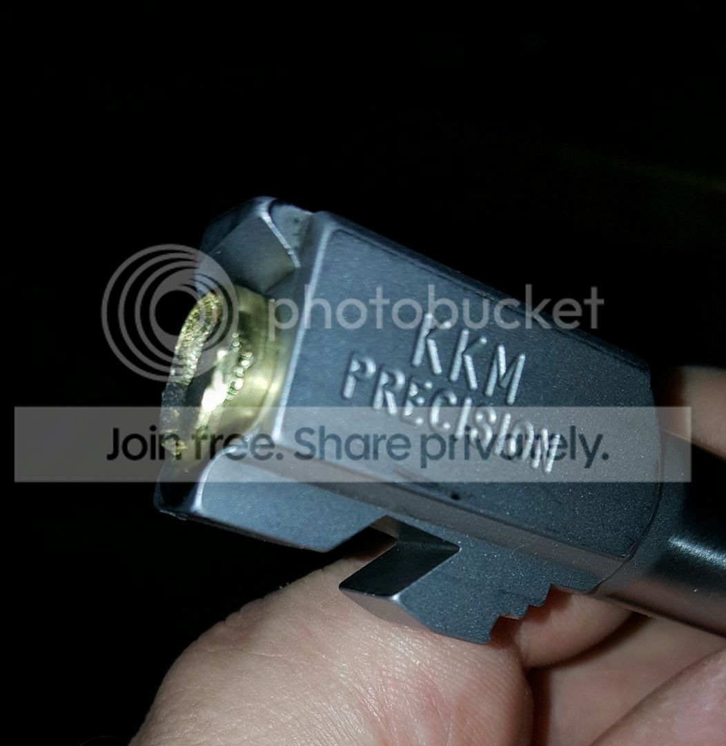

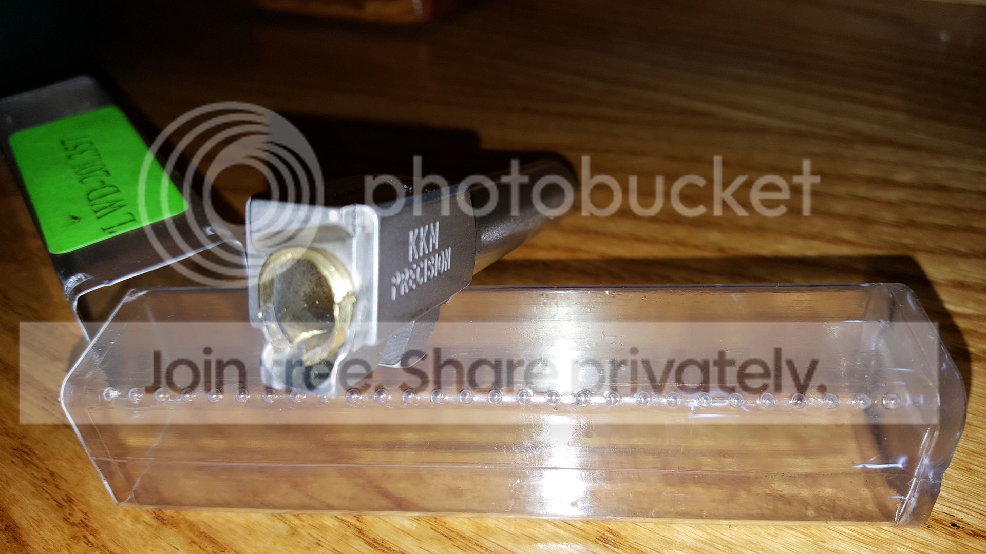

Hi again guys,
Here is a photo of the case in the barrel:
Jim
Is it possible that the KKM barrel is undercut at the feed ramp excessively?
The casing seems to be cracked and blown out more at the bottom.
Also, I seem to recall reading where Glock was experiencing this with some .40 caliber barrels when they undercut the feed ramp more, to facilitate even greater feeding reliability.
I have also heard of instances where bullets telescoped inward, creating very high pressure on firing.(not barrel-related)
Standard .40 cal. ammunition runs at 35,000 PSI, which is as high as .44 Magnum.
Telescoping inward by 1/10" reportedly doubles the chamber pressure.
