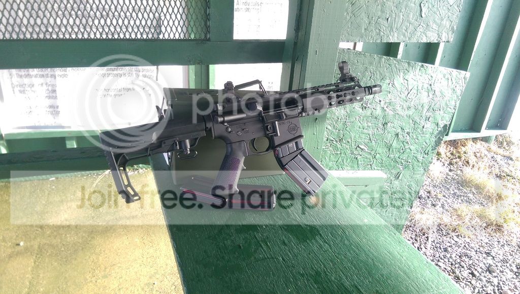

Good news! Finally got to the range this morning (beautiful morning out there!) to try out the little 7" 7.62x39 upper.
With the LMT Enhanced 7.62 Bolt Assembly, ran 90 rounds through her, and only one fail to feed - looked as though the mag wasn't fully in and she brought up. Other than that, she done excellent. No trouble for quick follow up shots. Gives a lot more sway than my Spikes 10.5 with the TTO Brake though. Not sure what's offered for brakes in 7.62, I'd certainly like to look into it. A slim red dot like a Holosun would be a great addition as well, however I did like using the#irons! Definitely want a straighter K2 grip rather than the stock A2.
Mounted on my SFRC Lower, only other things are an MFT Minimalist stock. Running a Carbine Spring and Spikes T2 Buffer.
I've got to say, this is one of the funner firearms I've shot, the compact-ness is foolish! Gets me closer to an UMP45 feel :D#Certainly worth getting the LMT Bolt Assembly - with 10 round mags, it pushes me away from the VZ's - never thought I'd say that! lol
Mounted on my SFRC Lower, only other things are an MFT Minimalist stock. Running a Carbine Spring and Spikes T2 Buffer. Here's some pictures for ya:
