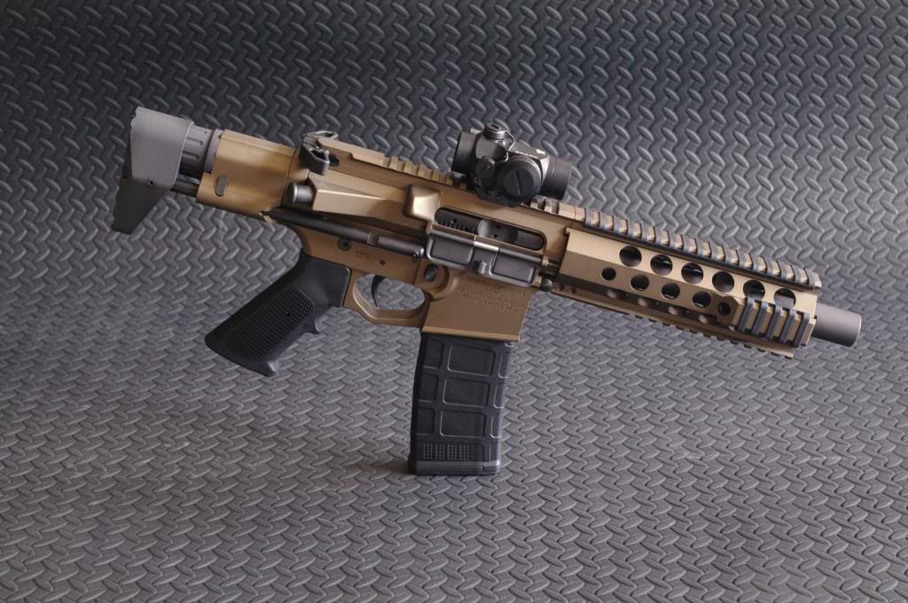

Hey Simon, as promised here are a couple of pictures of the 12.5" s&j with your low profile block and the NEA gen 2 9" rail. I have pretty much exactly 2 1/2" from the back of the threading to the NEA rail.
And I would say an 1 1/4" free internal space on the NEA rail.
Hope that helps.
