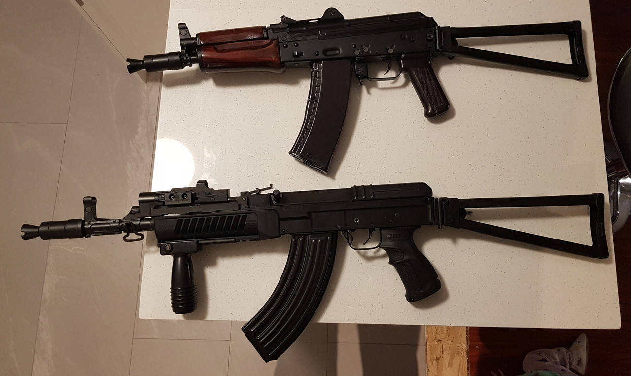

how easy was it to remove the VZ58 feeding lips of the mag ?
and did you use epoxy to bind to the bakelite mag?
Pulling off the CZ mag to was just a matter of drilling out the spot welds and some gentle persuasion. Less of an issue as the holes it leaves make a good anchor point for the binder. Once enough material has been removed for the bakelite to fit just make sure to roughen up enough of a binding surface. I actually etched some slots on the inside of the mag to add surface area for the bind. Its definately more art and experimentation than science I assure you.
In this case I used Devcon Plastic Welder II for the binder as I wasn't sure what the makeup of the bakelite material was and I've had good luck with the Devcon product. If it can hold pieces of a reciever together over thousands of rounds and cleaning then it should be able to handle a mag (albiet I did give it lots of time to reach full cure before putting any spring tension onto it)
And it feeds?

Sorry to burst your bubble, but there's no way that top cover is going to work on a VZ. It'll be a jam-o-matic. Looks great though, and it's always nice to see people going the extra distance to try new things.
If the old cover is underneath it should, but it looks like a dremel with a cutting disc will need to be used to cut away for bolt handle travel. There is no way those sights line up. Krink handguards go in, not bulge out. However, this is the sweetest thing I've seen all year.
